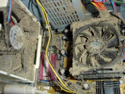

I fixed an old ladies computer one time that had failed...I opened it up and everything was covered in yellow smoker tar and it was just disgusting...the heatsink/fan for the cpu got gummed up and fried it. -
Still one of my favorite pics.
