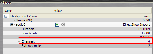

When you open your 6-ch input wav file, does it say 6 channel audio in the input box for the value column? or is it detecting it as 2-channel input when it should be 6 ?

EDIT: I uploaded a tiny 6-ch wav sample for you to test
tdk%20clip_track2.wav -

Please check the test clip I uploaded above as input, it's 5MB
If it doesn't work properly (i.e. doesn't show up as 6-ch) , try uninstall/reinstalling MCR. If that doesn't work, and you're sure that your plugins are activated, contact Mainconcept support. -
