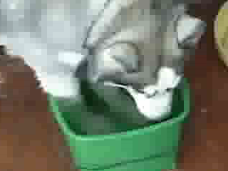

Frame size vs bitrate is a compromise. The smaller the frame the less bitrate it takes to keep the image from breaking up into macroblocks. But the smaller the frame size the blurrier the video will look when displayed full screen. Here are some severe macroblocks from too little bitrate:
