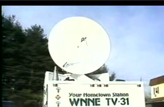

News organizations use satellite trucks with large dishes on the top, something like the pix below. Unfortunately the truck must remain stationary. Indy race cars use small microwave transmitters, but they only work if you can see the vehicle(s) at all times.
EDIT: You might be able to "hop" the video via a helicopter and then uplink it to a satellite. I'd really hate to see the invoice for all of that, though.
