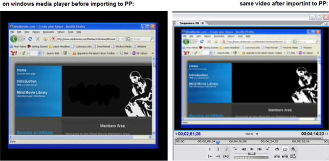

    Hi, Back!
    OK, looks like the quality of the video I am putting into PP is good. I watched it before importing to PP and it looks nice and crispy. Once I import it to PP it becomes blurry. What settings can I mess with inside PP to correct this?
    Below is an image of what the video looks like when I play it on Windows Media Player and another image of the same video imported to PP.
    Am I on the right track here and providing the right information?

    Mar 2009
    I know it is hard to tell the difference, but the one on the left is completely clear and perfect quality!
    Mar 2009
    Also, please note that this is a video of a website being viewed from a browser.

    it would be better if you posted a few second of before and after footage for comparison.
    Guns1inger,
    That was what I tried doing here.. one of before PP and one after. Not what you mean? I guess my post is just a fancy way of asking how do I mess with the quality settings inside of PP which I have not figured out yet? Is there a way to do this? After I find out how that is done, I can try that to see how it goes from there.
    Thanks for your help!
    Nelson
  14. Always Watching guns1inger's Avatar
    Apr 2004
    Miskatonic U
    Video clips of the source, not very small images that really don't show us anything useful. Hint : If you have to say this : I know it is hard to tell the difference, but the one on the left is completely clear and perfect quality! then your images aren't helpful.

    Mar 2009
    OK,
    Here's the image of the one before (clear) video from WMP. (this is as large as I could get it):
    Mar 2009
    Originally Posted by nfreytes
    OK,
    Here's one of the after (blurry video) on PP:

    Video clips. Not still images. Still images don't tell us very much.
