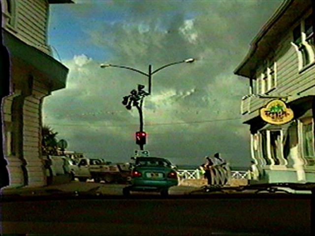

I purchased few months ago AverMedia capture card for this conversion process and the captured video looks like it does not have the lines vertically aligned (picture distorted and squigly black space to the left of the edge). This distortion constantly shifting - basically unusable. I am including frame picture. I figured maybe it is because the card was fairly inexpensive.

Better VCR required, with built-in TBC.
Thanks for the reply but these are 8mm tapes being played from my camera. How would the VCR get into play?
If those are first generation tapes then a DVD recorder with a line TBC should work.
Panasonic ES10, some other ES series, maybe one of the EZ series.
What happens if you input a DVD player composite to the capture card, does it show normal?
If so, then maybe the sync tips are surppressed from the camera and the TV is more forgiving for sync amplitude problems. -
Easiest way to fix the problem is to use a dvd recorder,i was getting the bends on certain 8mm tapes to capture but none with a recorder.
