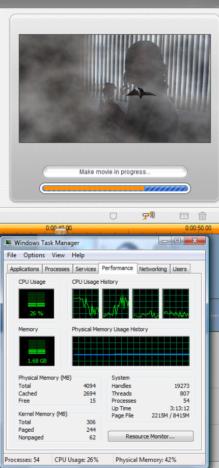

    looks like only 2 are going? here is the rendering with task manager.. i see what you mean about checking the 4 Cores, 4 pics in CPU Usage.
  6. Total CPU usage is 26 percent in that shot. The program is single threaded. Windows may bounce the program between different cores to even out the heat generation but the program is only running on one core at a time. Task Manager doesn't have the temporal granularity to see that.
