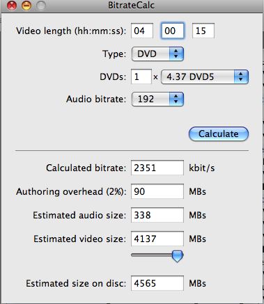

First, get a Bitrate Calculator, I like to use this one here.
Next, figure out quality vs quantity. In other words, how
much quality can you afford to lose to get yoru video onto a disc?
for me, with each episode at about 1 hour, I shoot for 4 episodes
per disc.
so using the Bitrate calc, I figure out the following :
4hrs00mins15seconds, with a defualt audio of 192kbps, gives you
a set encoding rate of 2.3mbps low end.

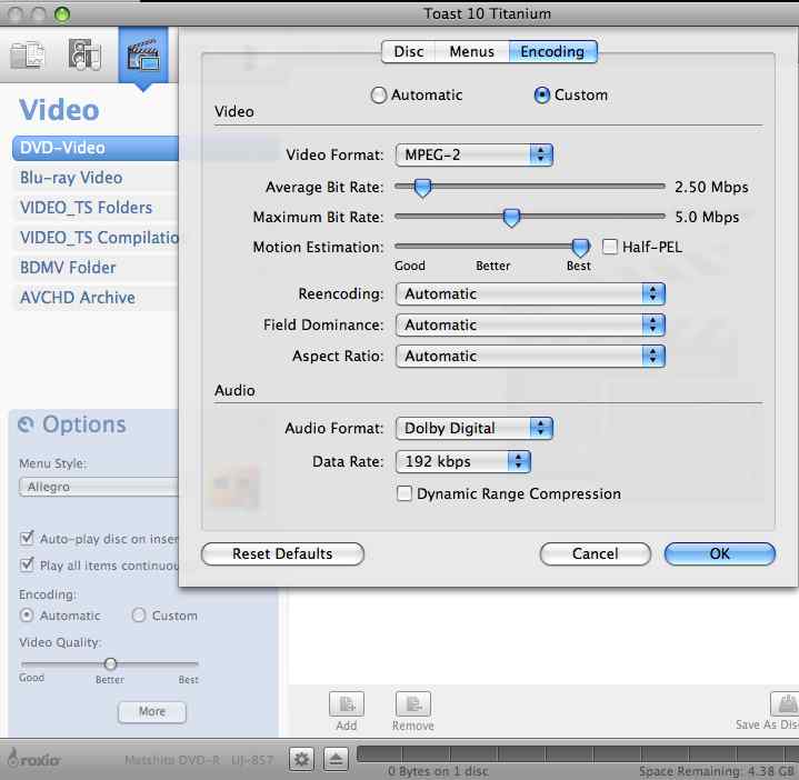

Launch Toast.
With Toast Open, select the Video Tab, select the DVD Tab.
At lower left, where the "Options" window resides, click "More."
When the "More" window comes up, select the "Encoding" Tab,
and enter in your information by doing the following:
You set the encoding to Custom, you set the slider to closest to 2.3mbps,
( in this case 2.5mbps) and set the high end to 5.0mbps.
Set the audio to 192kbps.
Click Ok, and then drag and drop your files into the main window.
Click burn to author and burn to DVD.

An average bitrate of 2.5Mbps on a typical 720x480 encode is going to look like shit. The minimum bitrate for acceptable quality is 5000-5500kbps (5.0-5.5Mbps).
At 352x480, only then will 2.5Mbps be okay.Want my help? Ask here! (not via PM!)
my 2 cents (I don't use Toast encoder):
I will increase Max BiteRate to 8 Mbps (if the frame cannot be described in 5 Mbps, the encoder will damage it)Originally Posted by terryj
…but I don't know if toast will manage to keep its average bitrate
I will set Motion Estimation to good (the better way will be to remove motion estimation)
The motion estimation is used to build GOP with accuracy, depending on the contents (=cuts) of the video
Without ME the GOP will always use 12 or 15 frames per GOP (and a long GOP uses a lot of B frames, the "lighter" frames)
With a best ME, the encoder can add more GOP (eg: each 3 or 6 frames), the resulting stream will use more I frames (the heaviest frames)
