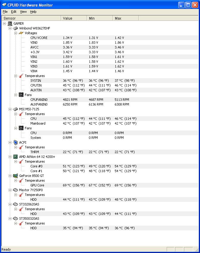

Heres' a screen grab from HW Monitor...

Your GPU core temp seem a bit on the high side if it's a idle temp. Does that 8500GT have a fan on it? Was that screen shot taken when the computer was doing something that could stress the GPU? Mine usually run about 50C and up to 55C at the highest. Your CPU and case temps look OK, but they could always be lower.

My fanless 8600GT idles in Windows XP around 50C too. If you are running Vista's Aero interface you might expect something hotter since it is using the 3d functions of the chip all the time. Try turning Aero off and see if you still have problems.
