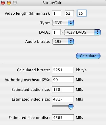

If you have 112 minutes of footage, according to the handy
bit rate Calc, you should be
the above is at a Constant Bitrate encode.
Adjust for a variable bitrate and you can push the
encoding to a low end of 6.0mbps, high of 8.0mbps.
Which will still bring it under 4.5GB easily.

ok.
Well then according to the Bitrate Calc you can
set up a Variable Rate Encode Preset in Compressor,
with a low target of 5.1 and a high of 8.0.
Your audio will be set to 192kbs AC3, 16bit 48khz.
