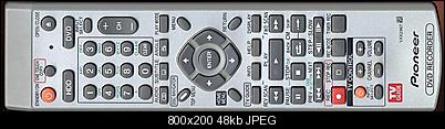

    Hi there,
    I have one of these remotes too and after it cleaning it up due to a battery leakage, a couple of buttons isn't working (and the most important ones; up, down, left, right button.)
    Anyone knows the right way or the trick to open this remote?
    Thanks.
  4. It is difficult to open without inflicting cosmetic damage. The battery leakage probably didn't reach the buttons but ruined part of the circuit board, something you likely won't be able to repair. But if you want to try anyway:
    First you need to remove the batteries and the two screws on the back holding it together. One screw is in the hole near the top, the other is at the bottom under the battery cover. These are Phillips head (Size #0) screws. After removing the screws you need to pry the covers apart along the seam that runs around the middle. Everyone has different prying tools and tricks (Apple iPod tools, credit cards, paint scrapers). It is hard to recommend a method because much depends on your intuitive skills. You'll need to clean the battery gunk off the circuit board and button contacts with a cotton ear swab moistened with white vinegar. If that doesn't reactivate the buttons, you may need to replace their contact patches with bits of conductive tape superglued on. The tape is expensive, but better than the fluid in "remote repair" kits you might see online.

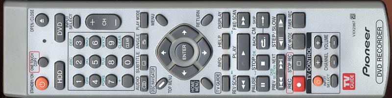

    Personally I would not bother repairing this particular handset, which was the last (and worst) of the Pioneer DVD/HDD remotes. It has poor length/weight balance, the buttons are tiny, and some editing functions were inexplicably altered with this design. As Seeker47 noted above, any Pioneer DVD/HDD remote will operate any Pioneer DVD/HDD recorder, so you don't need this exact one. The best one by far for the 640 and later models is the silver-colored VXX2967 or similar (that originally came with the 530 series). Great button feel and layout, the editing signals are more intuitive, incredibly durable, and much easier to open/repair:
