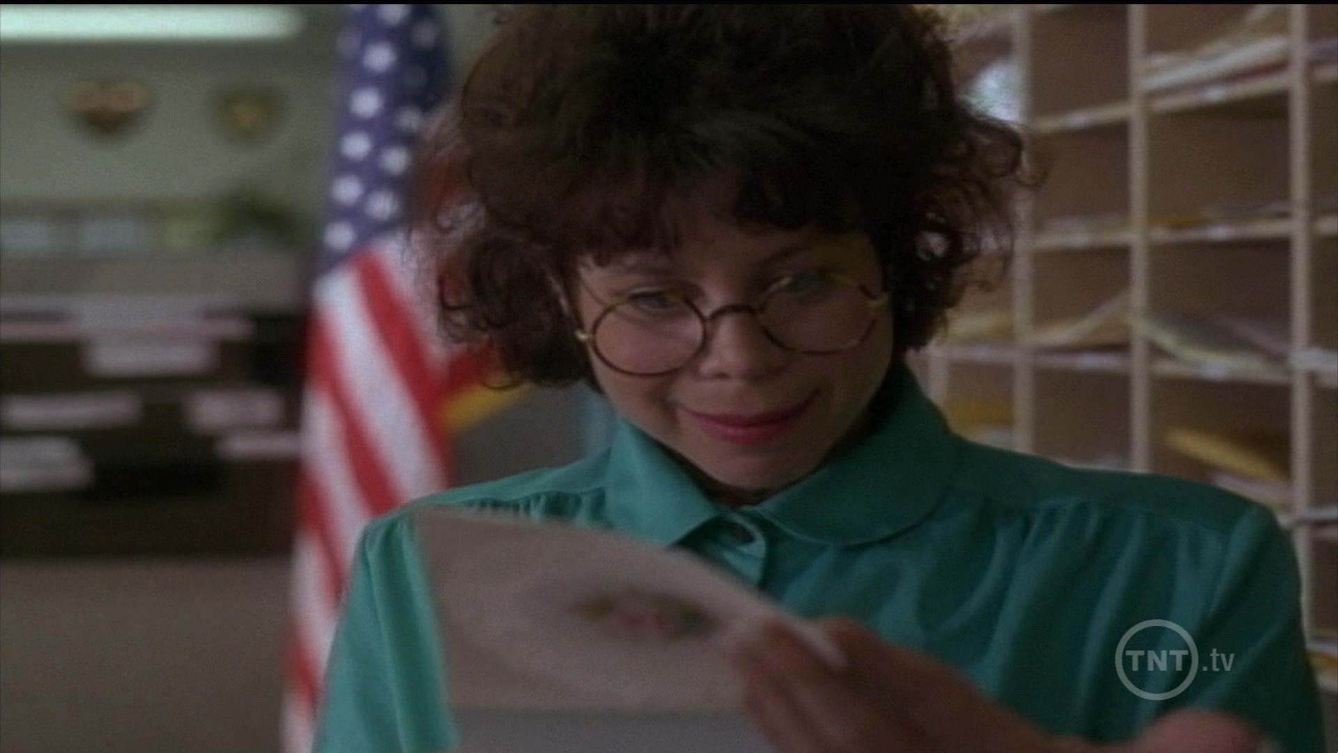

    It wasn't easy to find a still that clearly illustrates the issue, but I happened to see something from a TNTHD broadcast of the old movie "Clueless" that illustrates the kind of stretching I'm talking about. Looking at the woman in the picture, you can see how this kind of stretching makes her right shoulder look almost the right proportion, but her left shoulder (to our right) is much longer.

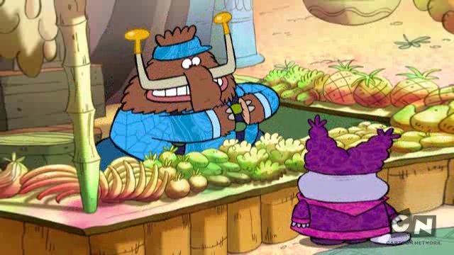

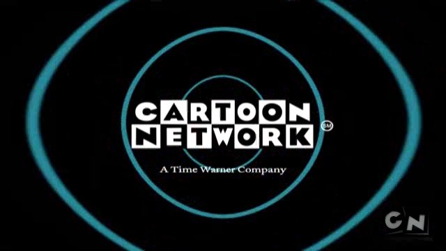

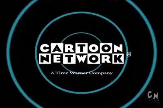

  8. I realize this thread's a year old, but it was useful to me. So I thought I would post some before/after results to prove that this filter works at undoing the non-linear/disproportional stretch.
    The line that worked for me was:
    v=v.WarpedResize(540,360,1.3,1)
    So this filter works and works well! Thanks to Midzuki, who knew the answer.
    Darryl
