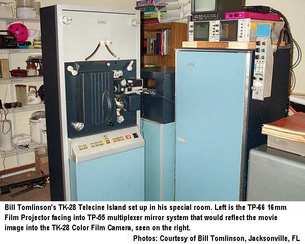

PS: The "old way" was to point a projector into a TV camera.
