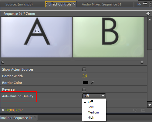

  3. You might also try the anti-aliasing quality setting in the zoom effects control (CS4 has this)
    You also have to pick a video codec (it says "none")

    Like to know where is this "zoom effect control" in CS4? Thanks
  6. You access it by touching the bar above the clip in the timeline . If you've applied the "zoom" effect transition, it will say "zoom" above the clip.
    I doubt this is your problem. Maybe you could describe what you mean by "flicker" or "stutter" because they mean very different things, or better yet post a sample as was suggested eariier. Also provide information on your input format, and output settings (codec, bitrate etc..)
