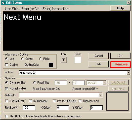

Well, I thought it could delete a current (sub) menu, and after doing so you'd refresh to the main menu.Originally Posted by borax
And/or when you r-click on the text button to edit it, there should be an option to "remove" it, as there is for the similar edit button dialog for a video button, as below:
I will check if this is possible (without to much changes in the source code).
