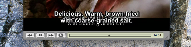

I'm trying to hard code subs onto avi using Autogordian knot 2.55 via vista.
The problem Im having is after encode takes place & I go to playback,theres 2 sets of subs on the screen ??
Am I missing a setting in the program or a filter ?

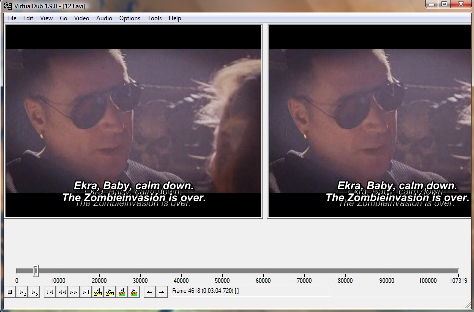

Open the AVI in VDub(Mod) and scroll around. If you see only one set of subs, that's all there are and the player is adding the second set, either through it's own subtitle engine, or through DirectVobSub.

Still same problem occuring,encoded avi + subs again using AGK.
Took the resultant avi file from one computer to another.
One which doesn't have vsob,agk,virtual dub or any other editing software installed,just plain old vlc and mplayer.
Also no copies of the same avi or sub files on the second computer either to be sure the player wasnt picking up the
original srt sub file.
Same happens again see pic.
Its a mystery !!

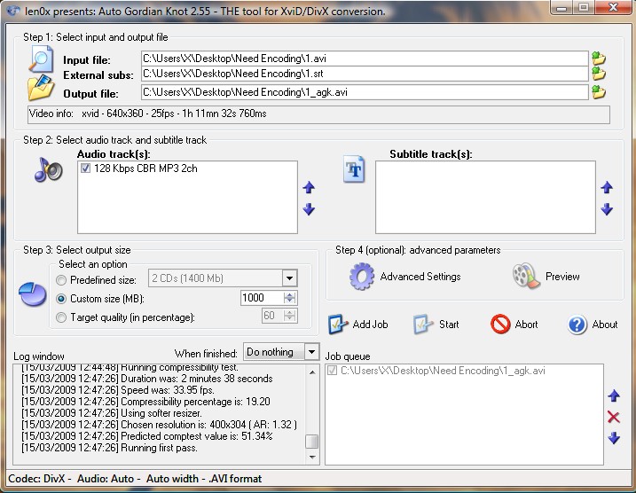

Also AGK screenshot:
On opening AGK I chose the file to be encoded seen in the top window.
CTRL + F8 to insert the SRT sub file into the middle window.
Finally Chose a separate destination folder for the output in bottom window.
Set the file size output to be 1gb,which this time AGK split the avi into 2 separate files ?
Secondly I tried the previous encoded avi in virtual dub as you suggested see pic :
The AVI doesn't have subs already embedded onto it ,it came with a separate SRT file in the folder.

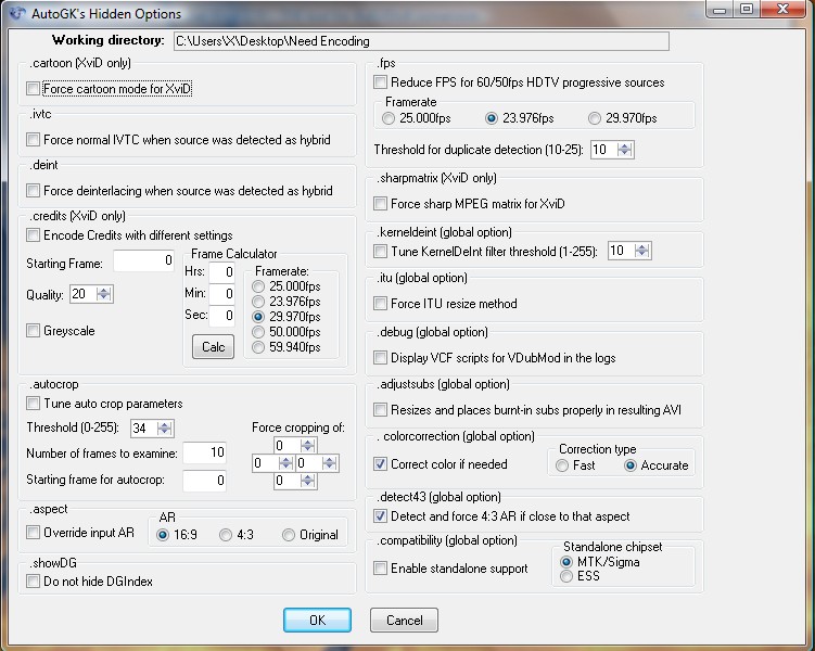

I know theres another trick for AGK - CTRL + F9 which doesnt have any Subtitle options in the Menu page.

Yep, it looks like you did everything right and that there are 2 sets of subs burned into the video. I've never heard of such a thing.
If you start with a DVD it's possible to add subs twice, once from the DVD itself and again using the CTRL-F8 trick with outside subs. That's what I was thinking (hoping) had happened.I don't know of any other way to add the SRT file without doing the CRTL + F8 trick,this method is suggested in AGK's tutorial on their site.
Do this; open the original AVI and then do a CTRL-F9. Is the "Resizes and places burnt-in subs properly in resulting AVI" box checked? If so, uncheck it and try again. Since you know about CTRL-F9, maybe you used that checkbox once?

Also accessed CTRL + F9 see pic :
The box you mentioned was 'checked' so I have 'unchecked' this time.
Also ran a quick preview & two sets of subs appeared again ??
However if I know where to get the AVI SYNTH log details from for the post I will run the encode process yet again.
It's normal to have 2 sets of subs appear during the Preview. One is from the embedded subs, as in the AviSynth script, the other from those external subs being displayed by the player. Go ahead and do the encode. With any luck the resulting AVI will have only one set of subs and the problem will have been that box in the Hidden Options you had checked.The box you mentioned was 'checked' so I have 'unchecked' this time.
You have to remember that any box you check in the Hidden Options remains checked forever unless you come back later and uncheck it. Something you changed for one encode may not be needed for subsequent encodes, so you have to be careful when fooling around in the Hidden Options. -
Encoding finished again with 2 sets of subs appearing on screen again ??
Thats with the box you mentioned earlier 'Unchecked'

[15/03/2009 17:56:25] Speed was: 34.06 fps.
[15/03/2009 17:56:26] Compressibility percentage is: 19.20
[15/03/2009 17:56:26] Using softer resizer.
[15/03/2009 17:56:26] Chosen resolution is: 400x304 ( AR: 1.32 )
[15/03/2009 17:56:26] Predicted comptest value is: 51.34%
[15/03/2009 17:56:26] Running first pass.
[15/03/2009 18:28:21] Duration was: 31 minutes 54 seconds
[15/03/2009 18:28:21] Speed was: 56.04 fps.
[15/03/2009 18:28:21] Running second pass.
[15/03/2009 18:59:31] Duration was: 31 minutes 8 seconds
[15/03/2009 18:59:31] Speed was: 57.42 fps.
[15/03/2009 18:59:32] Splitting video into: C:\Users\X\Desktop\1_agk.cd1.avi
[15/03/2009 19:00:28] Splitting video into: C:\Users\X\Desktop\1_agk.cd2.avi
[15/03/2009 19:01:23] Job finished. Total time: 1 hour, 29 minutes 26 seconds

And you opened the finished AVI in VDubMod again to check? VDubMod is only going to show what's in the AVI, whereas if you play the finished encode in a player, the separate subs may also get played.Encoding finished again with 2 sets of subs appearing on screen again ??
The AviSynth scripts show the subs being loaded only once. So, if there are really 2 subs again, I'm baffled. This looks like a job for the developer, len0x. He can be found at the GKnot Forum at Doom9. If you've never registered there before, then you have to first register and then wait 5 days before posting. I may be able to get the ball rolling before then. Maybe I'm just not asking the right questions, or not looking for the right things.
By the way, open the SRT sub file in Notepad and start looking for the double subs. Either every sub shown twice, or maybe after they've all been listed once, that it lists them all over again. Is there anything at all unusual about that SRT file that you can tell? But I'm just clutching at straws here, because I don't really think that's it.
This is the only AVI you've ever had with this problem? The ones you did before worked OK? Have you tried to work on any since this problem appeared? If not, do you have any others handy on which to test to see if this is the only AVI with this particular problem? -
Checked the SRT file & only 1 line of text is visible,there's no duplication ?
Tried in virtual dub again & got the same amount of subs appearing.
Tried in VLC got 2 sets again,tried Realplayer got 2 sets ?
Transfered the avi to another computer,same again 2 sets.
Also tried to encode another different avi & got the same results !
Before I've begun to start encoding any recent avi I've played the raw avi + sub srt text file from the same folder
