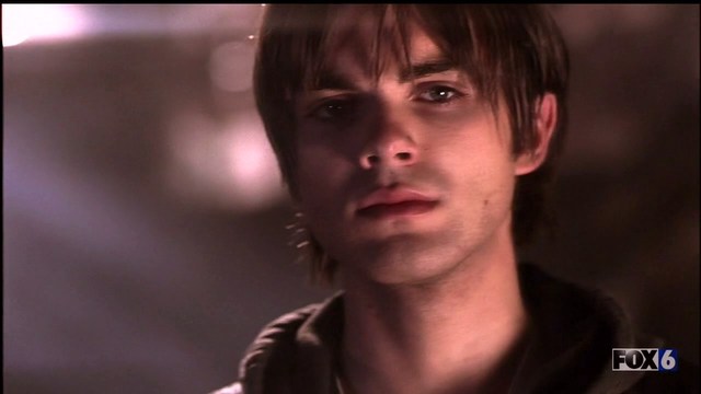

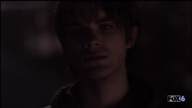

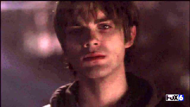

  6. The frames that are not complete black can be partially restored. The darker they are the more problematic they will be -- the parts that have become completely black will have no detail left. You will probably end up adjusting them one by one. And you will bring out lots of compression artifacts that were too dark to see in the dark frames.

  8. Normal frame, just before fade to black:
    Dark frame near end of fade to black:
    Dark frame lightened (VirtualDub) to approximate the normal frame:
    These were from a h.264 encoded video. You could do a little better if you spent more time on it. I don't know which would be more distracting -- the temporary fade to black or the normalized restoration.

    You could try brightening a few frames, using Tweak, but this is unlikely to be very successful, as Jagabo's demonstration shows, it would look posterized.
