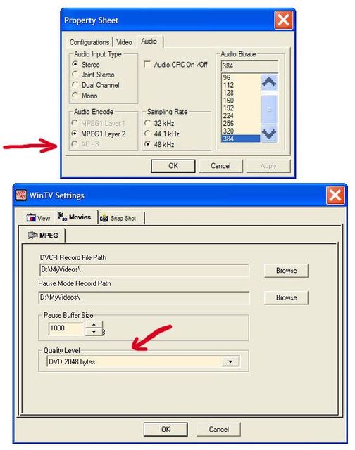

So then if I need my audio in ac3, not mpeg, to make a 100% compatible DVD disc, I look at that WinTV software Hauppauge uses and if I select over the air antenna double digit channel, I can see that AC-3 audio option is there but is grayed out and people say WinTV only captures mpeg audio and not ac3 [see top part of the attachment] so how can I capture ac3 audio then if there is no software that captures ac3 directly?
If I select a four digit over the air HD channel, I get only one option: DVD 2048 bytes, well what's the audio there, mpeg still or ac3? [see bottom part of the attachment to this post]
Edit: I guess those are HD, they're not for making standard DVDs out of unless I render the video down to standard TV but then it'll also have those black bars like when I used to capture from an HD channel to my old standard capture ATi?
Two side questions:
1. Why is 384 audio bit rate max, I thought that 448 was?
2. Stereo, Joint Stereo or Dual Channel for Audio input type?

The only time you will get MPG audio is when doing an analog capture with standard stereo sound being input. This is quite simple to convert to AC-3 for maximum compatibility. Takes minutes and can be easily automated, quality loss is minimal.

With analog captures you get what the MPEG encoder chip in the HVR-2250 can output. MPEG2 video and stereo MP2 audio. If you want AC3 audio for DVD you'll have to capture MP2 and convert to AC3 later.
There's no reason to go higher than 384 kbps with a stereo source. Nobody can hear a difference between uncompressed PCM and MP2 at 384 kbps. -

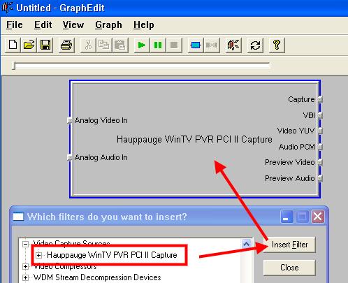

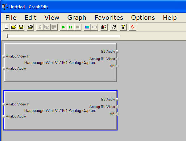

You might be able to capture off the preview pin of the 2250's driver with GraphEdit. SHS has information about that.Originally Posted by c627627 -
Not all Hauppauge cards have preview pins. Did you add the capture filter? Graph -> Insert filters -> Video Capture Sources -> Hauppauge whatever.

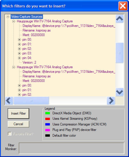

Thanks for the GraphEdit tip, let's see if we can make this work yet, here's what I have and can you please tell me what next:
Click on one of the "Hauppauge WinTV Analog Capture..." items then press Insert Filter. That will add the filter to the main window. Look to see if it has a preview pin. From there on out it gets difficult trying to figure out what filters to use to create a file you can do something with.
As you can see below Insert Filter for both options adds as pictured. Since there is no Preview option, does that mean that cards such as this one cannot be used to capture uncompressed video?

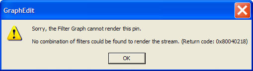

Try right clicking on the Analog ITU Video pin and selecting Render. What happens? Assuming it makes a graph press the Play button at the top. Do you see video?
I don't know exactly what your card supports but my old PVR-250 allows MPG capture up to 15,000 kbps. Captures at that bitrate are very clean and suitable for editing and reencoding to DVD bitrates.
Regarding current capture cards: I don't know which ones can capture uncompressed or losslessly compressed. -
This happens:
So unless you have any other suggestions, is it safe to say uncompressed video is not possible with this card?

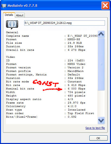

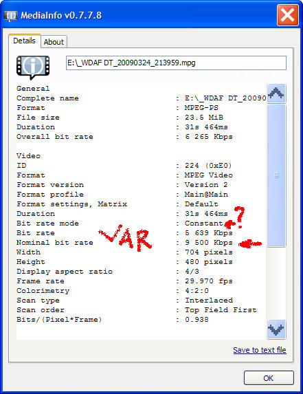

But look at the issue with MPEG video I just discovered with WinTV, [first of all if I select any *constant* bit rate below 6,000 all is as it should be] but if I set any *constant* bit rate above 6,000, any one at all, this is what's captured, they're all at 6,000 kbps!
And if I set a variable bit rate at 9500 or higher, they're all at 9,500 kbps Nominal:

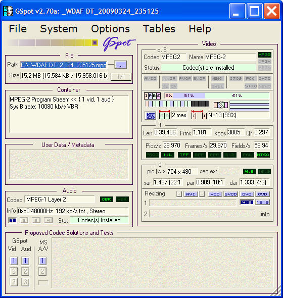

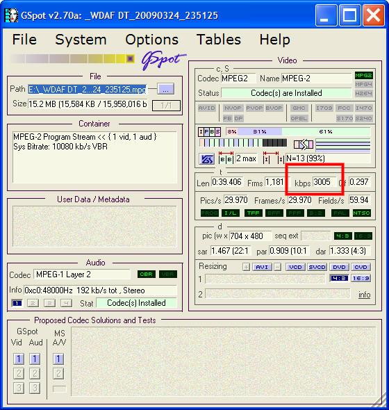

I'm pretty sure MediaInfo only checks the header of the MPG file to determine the bitrate. The header can say anything -- it doesn't indicate what's really in the file. Check the bitrates with GSpot. It scans the files and reports the real bitrate.
Also, setting your own bitrate in WinTV2000 is a little tricky (at least in the older version I have, I'm not sure about the more recent versions). You have to go to the Advanced dialog where you set bitrates. Set the audio and video bitrates, then go back to the Configuration tab, type in a name, and "Save New Config". Then go back to the previous dialog and select the profile you just created. -
Yeah, I know, if I tried to make it less user friendly I couldn't, whoever designed the interface sucks.
But the reason I know I did it correctly is because as long as I was below 6,000 kbps, MediaInfo correctly reported what I had set as contstant bit rate below 6,000.
Funny thing, GSpot reports all of them as 10,080 VBR, look:

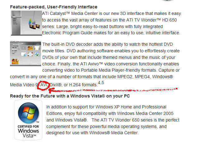

But look what I found:
http://ati.amd.com/products/tvwonder650/ (scroll down to Feature-packed, User-Friendly Interface to see the below captured proof that it can capture uncompressed video AVI.)
So unless you guys warn me against going with ATi, I'm leaning to just getting the TV Wonder 650 HD card and use it to capture uncompressed AVI as well as MPEG and do so with fewer hassles about volume levels and driver support and be able to capture at constant bit rates of over 6,000 kbps for sure.
You're looking in the wrong place. The average video bitrate of that file is 3005 kbps.Originally Posted by c627627
Regarding the ATI card you referenced and AVI, note it says "Capture or CONVERT..." But I do seem to recall reading in posts here that you can capture uncompressed AVI with that card.
