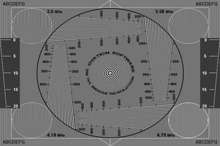

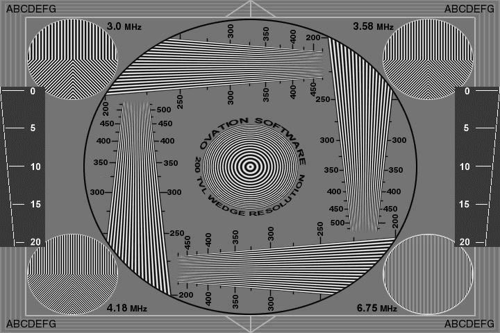

  6. Bigger frame size = more detail possible. And the larger frame can be sharper when both are viewed at the same size. But enlarging a small frame to a large frame won't add detail. At best you get a larger image without introducing too many scaling artifacts.
    Original 720x480 frame:
    Downsized to 352x240:
    352x240 upscaled to 720x480:
    352x480 captures most of the resolution of NTSC VHS tape. 720x480 will be a tiny bit sharper on the horizontal axis.
