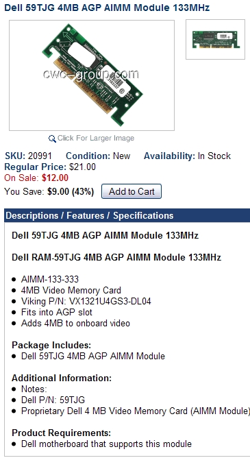

A friend gave me his old video card and I tried to put it in. I have an AGP slot for it, but there's currently something in it. It had "4 meg" and "133 mhz" printed on it, and I assumed that was the crappy video card already in it. I took that out, put in my friend's card, and then while I had the computer open I took out the old hard drive that didn't work anyway. Everything seemed fine. I plugged everything back in, computer booted up, monitor displayed the big DELL image, I was happy.

The video card thing is starting to worry me. This original card that said "133Mhz", did it have a video connection on it? So that originally, there were TWO video connectors, 15-pin three-row female connectors? One of them on the motherboard, and one on this "133Mhz" card. Your new AGP video card would have one, as well.
I am strongly suspecting that you have somehow jammed a video card into a memory slot.
Yes, you have added very important information that was missing in the first post. A large part of solving a problem often involves reversing EXACTLY what was done before. -
That's probably what was - a memory slot. I really have no idea what it was, I assumed it might be something to do with the video but obviously I was mistaken. So I think I'm all set now, just need to find myself a video card I can use now, as I've been told my PCI slots are like obsolete or something.

I do not see how you could try to put a video card in a memory slot - the VGA connector has to stick out the back of the computer to connect the monitor cable, and there is no way that the card could lock in place and you would definitely destroy the slot.
Could you possibly post pictures of the motherboard, the new video card, and whatever you removed from the slot that you are talking about - it would greatly help us to help you."I will not be pushed, filed, stamped, indexed, briefed, debriefed, or numbered! My life is my own" - the Prisoner

4mb 133mhz isn't a ram memory module. it's most likely an on-board video memory enhancement add-on in the agp slot. dell made them for awhile long ago.
before you remove the 133mhz 4mb module you will need to go into the bios and set the first display setting to agp. then power down. move the video cable from the motherboard output to the new agp card's and power back up.
I assume by BIOS you mean that setup screen you can enter just as the computer is booting up. I looked in there, and the closest thing I could find was under "Integrated Devices" it had something for video in there, and the options were "Onboard" and "Auto".
that would be it. you want to set it to auto, save the bios and shut down. then you can remove the old card, insert the new card and move the monitor cable to the new card.

So I had it backwards, it was a Memory card in a Video slot?
Seem to recall reading about these, but don't think I ever actually saw one.
