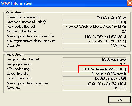

i have video i've been trying to convert with virtualdub using ffdshow. It says that a microsoft audio codec is needed. I put it into G-spot and it said the codec is 0x0161 (WMA v2). I did a search and was told to download and install the ac3filter which I did, but nothing has changed. What do I need to convert this? where can i download it?

No , there are 2 separate things that you need, the wmv plugin, and DivX WMA Audio which is an ACM type codec. There are licensing/legal issues with using WMV/WMA in vdub, but there are free versions floating around just search for those 2 terms I listed in my first post.

hmm...didn't work. When I extracted it, it had an inf file so I installed it from that and nothing. Then I put it into the plug-in folder (even though it didn't have a plug-in extension) and that didn't work either. Is there something I'm missing?
the wmv.vdplugin is in the vdub plugins folder, and I think you right click the inf to install. If you 've installed it correctly it should show up in the vdub audio compression menu. This won't work on 6-channel WMAPro, only WMA2 like the id code you gave. What error message (if any) are you getting when you open in vdub?

went back, tried it and it worked! I did the same thing as last time don't know why it worked this time but thank you poisondeathray!
