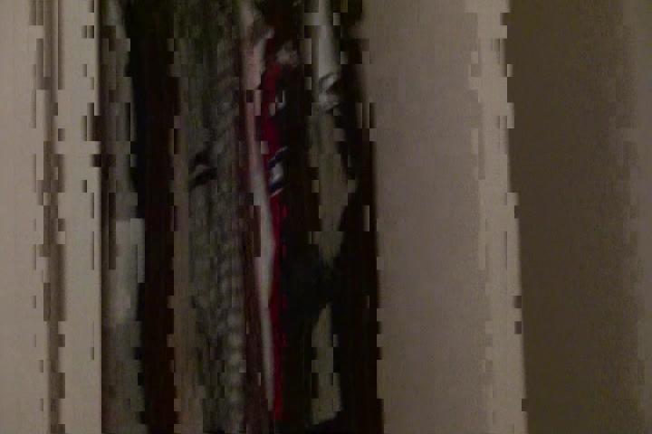

I attached a screenshot of one of the video's. It's clothes hanging in my closet.

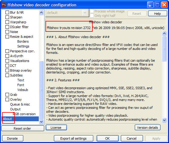

You can check the ffdshow version in the configuration by looking at the "about" category - see below.

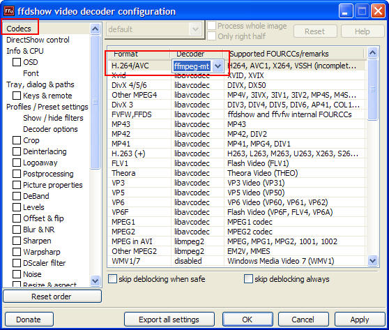

Since you have a dual core, use ffdshow-mt to decode:

I have ffdshow tryouts revision 2734.
I've set ffdshow-mt to decode as you said.
Yes, that's a low quality sample. I got so frustrated that I tried with SP, hoping that I could at least edit the video.

The blocks in the image remain. Especially when I zoom.

Now I have Haali installed, I have ffdshow installed, and the have ffdshow-mt set in the configuration to decode h.264 I installed the graphstudio and attached an image of what it shows:
When playing the avi files the Haali icon shows and ffdshow audio decoder icon shows, but the video decoder icon doesn't. How do I fix this?

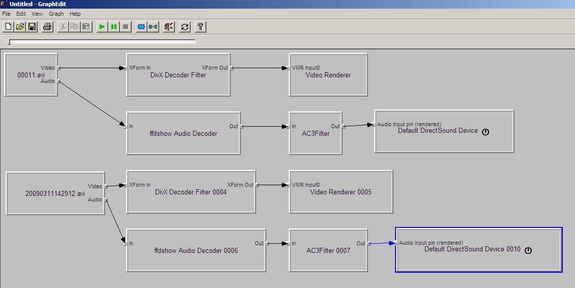

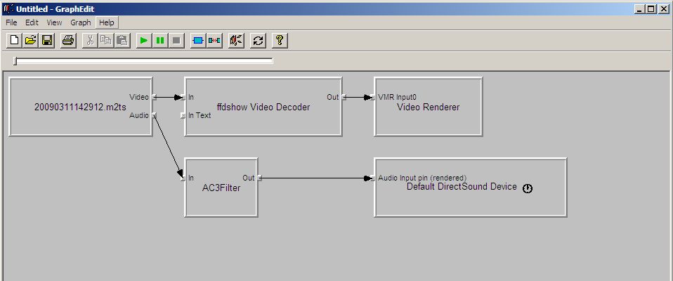

Render your .m2ts file with graphstudio / graphedit
Why are you using the avi file? Where is that from? Is it xvid converted avi, or avc wrapped in avi ?
Which DivX decoder is that ? Is it DivX 7 AVC decoder? right click it
You can unregister or lower the merit of decoders/filters with graphstudio, or with radlight filter manager

Xvid decoder was disabled in ffdshow. I set it to libavcodec and the divx avi seems to be running smoothly now with powerdvd. I'm still updating WMP from 10 to 11 right at this moment.

It's xvid converted avi by xvid4psp.
It's DivX 5.1.1Originally Posted by poisondeathray

If you see the haali icon, and ffdshow icon when playing the original files using a directshow player (e.g. mpc, wmp), it should be much smoother with ffdshow-mt, also your conversions using directshow shouldn't crash - unless there are other issues (e.g. laptop overheating, viruses, other apps etc...) -

You need a proper DEcoder for the source (ie. the m2ts source file), in order for that data to be fed to an ENcoder to re-encode to a final format eg. wmv, divx,etc... The .m2ts first needs a splitter to split the audio & video data to be fed to their respective DEcoders. It was obvious that you were not doing this by the 1st screenshot, but it seems like you got things working out
