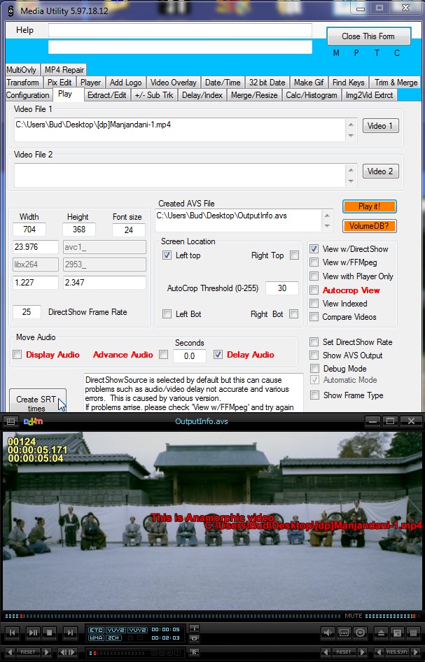

    You should be able to use FFprobe to get frame timecodes and create the SRT file. The SRT file is going to be large if it contains every frame, if I understand correctly what you want.
    Although FFprobe is a Command Line program, you should be able to create a batch file that will create the SRT. It should also be fairly easy to create a no frills GUI, Using FFprobe.
    An alternative would be to use an AVIsynth script to show the times and whatever else you wish with an AVIsynth capable player.
    [Attachment 48417 - Click to enlarge]

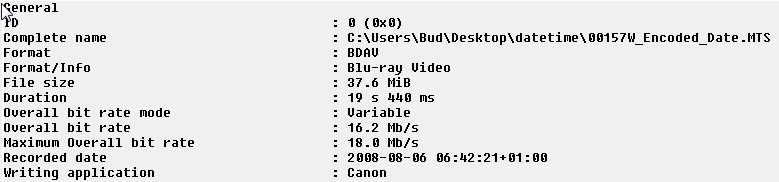

    MediaInfo will do this for you. It also has a CLI (command Line) version that can be used in a batch file also:
    [Attachment 48419 - Click to enlarge]

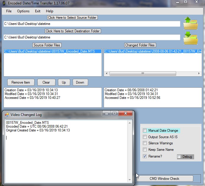

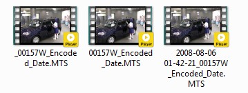

    I already use this method in the Date Time change program I wrote:
    [Attachment 48420 - Click to enlarge]
    [Attachment 48422 - Click to enlarge]
    If you want an SRT file to show each frame while playing, using FFProbe , IMHO, is the best because frame times can vary slightly frame to frame for several reasons.
