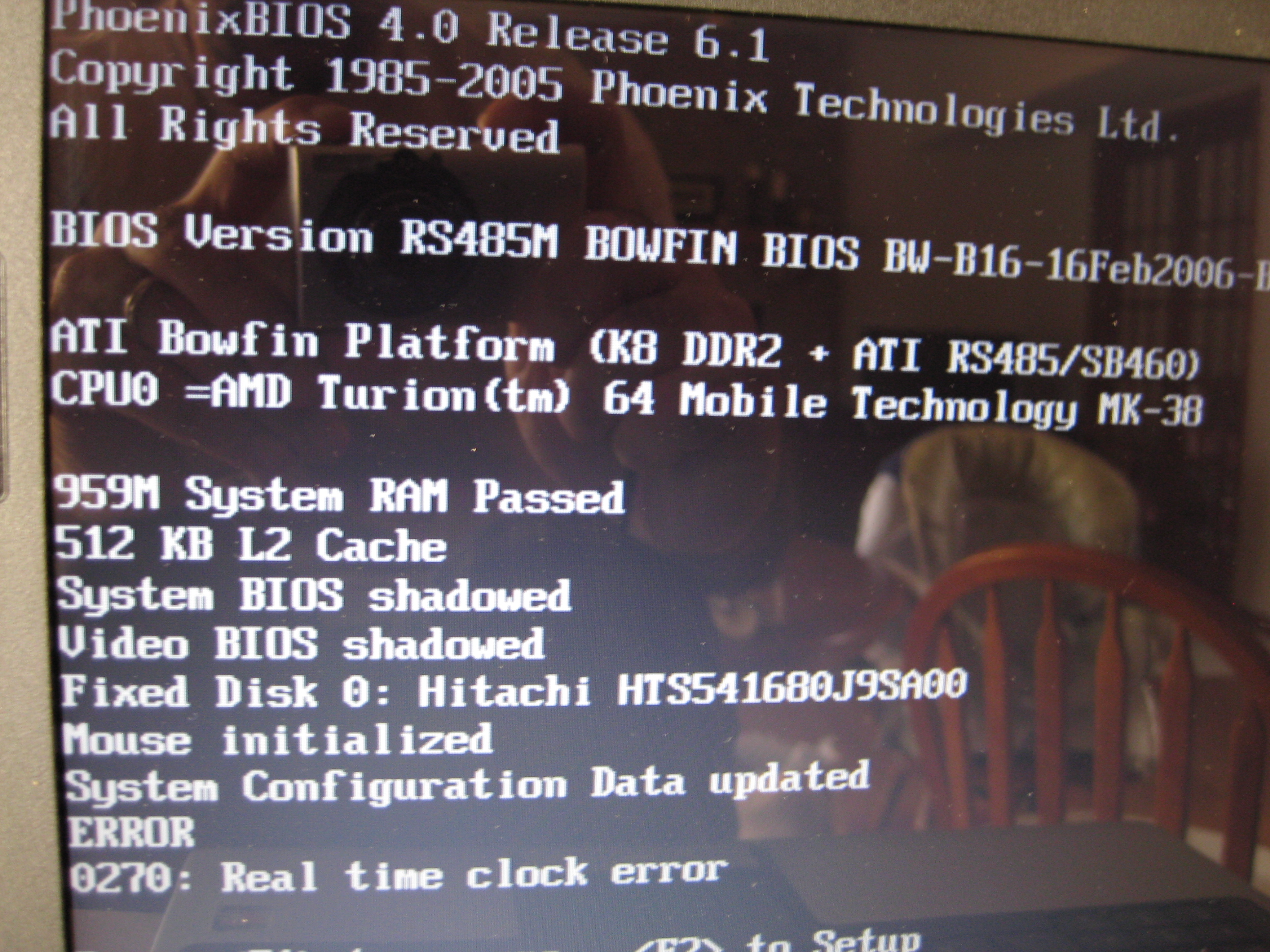

2-if you remove the main battery.the timer goes back to 2006(pix)
3-even after fixing the time/date.same thing happens again when it turn it off

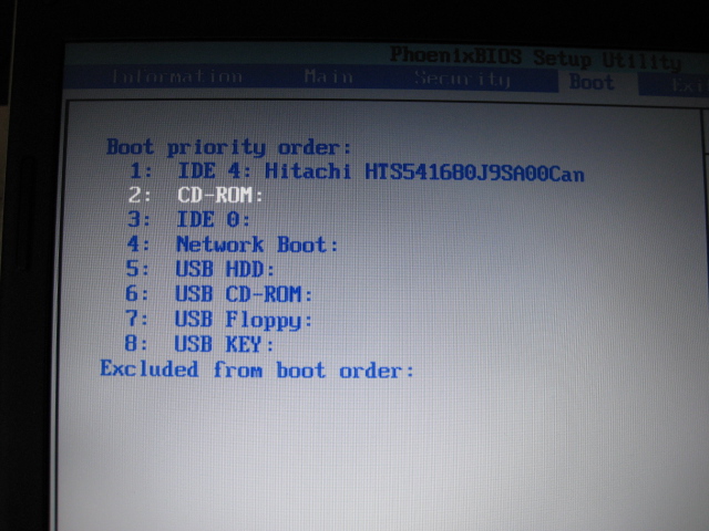

Go into BIOS setup and see if the second fixed adapter is set to none - if so, then change the setting to auto or CD ROM - sometimes this setting gets lost when the CMOS battery is dead."I will not be pushed, filed, stamped, indexed, briefed, debriefed, or numbered! My life is my own" - the Prisoner

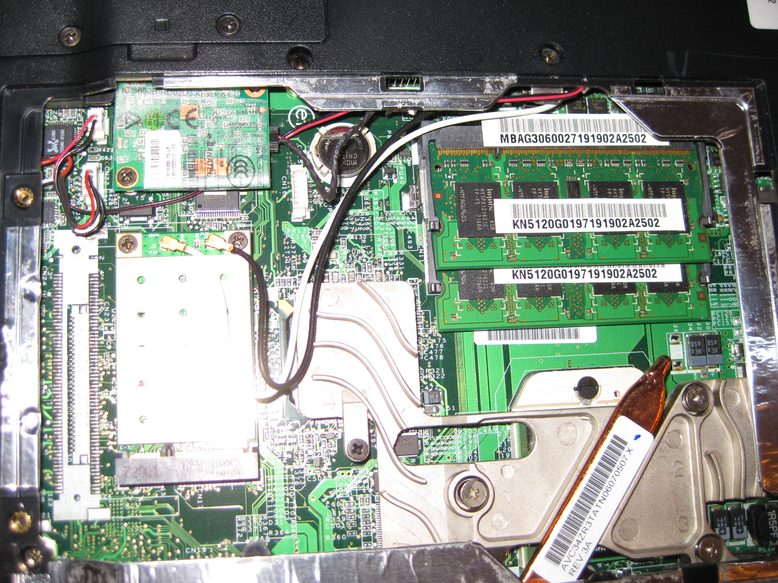

good news .The CMOS battery is next to the memory (check the pix)
I bought the RC1220 3V Battery for less than $4 .it's the same size like the ML-1220.took 1 min to open the tray and install the battery.

Did you mean a CR1220 battery - this is a 3 volt 38mah battery - it will not work. An ML1220 battery is 3 volt and rechargeable. You must get the exact same type battery.

BTW .I changed the boot sequence from hd 0 to the Hitachi harddrive(no auto). dvd still no show under both BIOS and windows
the BIOS is very simple and not a lot of options like votage and stuff like that -

BTW .in the 1st pix I posted you can see the 0270 real time clock error .according to this site it could be one of 2 things
1-Replace the backup battery and run the BIOS Setup Utility to reset the time and date.
2-System Board
http://www.google-notebook.cn/ibm/14.htm -

Did you try to set the secondary disk drive to enabled, or something similar - I did not want you to set it to boot first. It is possible that the DVD drive is interfering with the boot process and slowing everything down - try removing it and see if it boots faster."I will not be pushed, filed, stamped, indexed, briefed, debriefed, or numbered! My life is my own" - the Prisoner

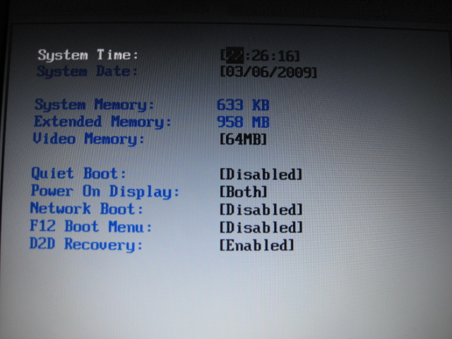

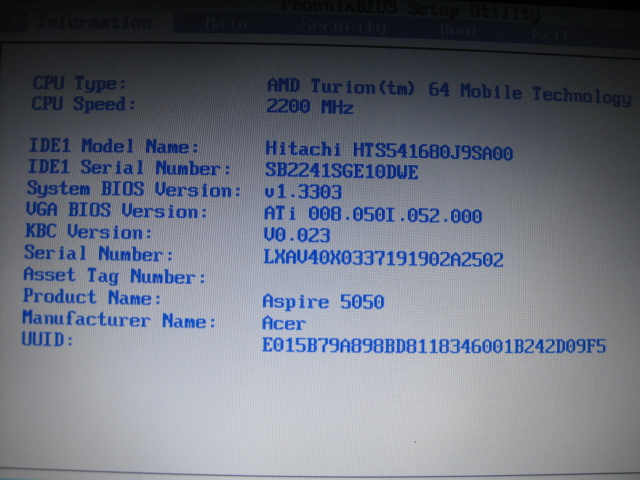

here some pix of the BIOS.Like I said.it's simple

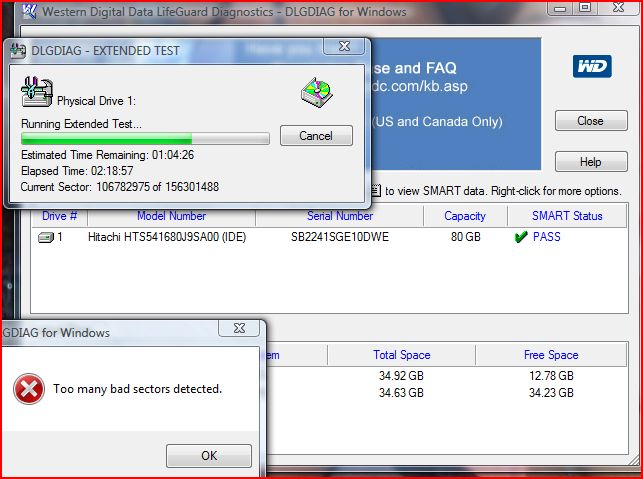

plus I scanned the HD with western digital data lifeguard .it passed the qiuck test,BUT it failed the extended test.
I'm ganna take it back to him tomorrow
Thnax you all for the help.
