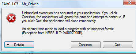

    I have tried using FAVC and when I try to generate a DVD with these two files I get the following [img]https://forum.videohelp.com/images/guides/p1945465/.

    The FAVC guy, Mr. Odwin, is a frequent visitor to this forum. Maybe he'll see this thread, because I have no idea what the error means.
