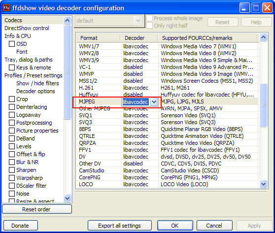

I do not have that ffshow currently. I can look into that but I would prefer to stick to what I have.

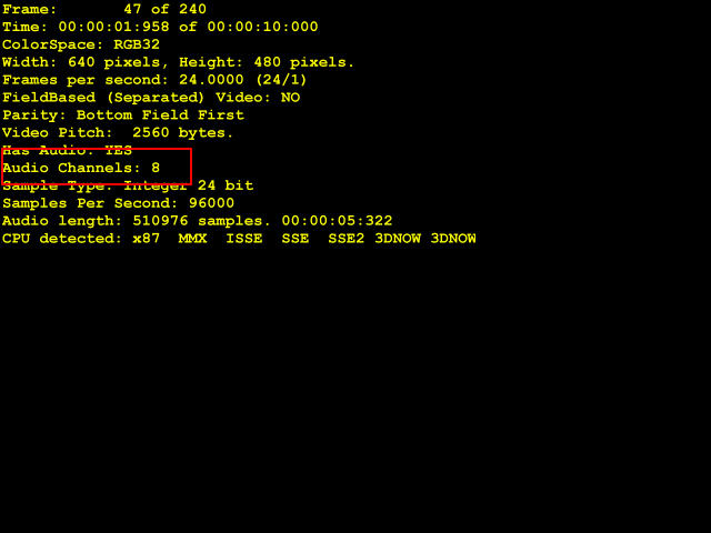

If you use
QTInput("file.mov")
Info()
And play in mpc, vdub or avsp, what does it say about the audio?
I think gadgetguy is on the right track with mixing audio, but the channels are a bit mixed up (L+R). They should be like this for 1,2,3...8
FL, FR, C, LFE, BL, BR, SL, SR
So 1,2,3,4 would be FL, FR, C, LFE ....but there is some FR that is "contaminating" the new "Left" stereo
You may have to do the audio separately, or demuxed if you still insist on avisynth, using Nicaudio ie. NicLPCMSource()
I just tested a sample , and the channels were mixed up, but the Info() shows 8 channel passthrough
I normally use this one for 6-channel, so you could probably change the weightings for 8-channelCode:vid=blankclip() LoadPlugin("C:\Program Files\AviSynth 2.5\plugins\NicAudio.dll") a=NicLPCMSource("8-ch lpcm.lpcm", 96000, -24, 8) lft = GetChannels(a,1,2,3,4).ConvertToMono() rgt = GetChannels(a,5,6,7,8).ConvertToMono() aud=MergeChannels(lft, rgt) AudioDub(vid,aud) Info()
So the channels might be the follow, (not sure how to mix the weightings properly, maybe gadgetguy can figure it out). You could probably just use the 6-ch mix, and omit br, bl (just change the niclpcmsource parameter to 6, instead of 8)Code:fl = GetChannel(a, 1) fr = GetChannel(a, 2) c = GetChannel(a, 3) lfe = GetChannel(a, 4) sl = GetChannel(a, 5) sr = GetChannel(a, 6) l_sl = MixAudio(fl, sl, 0.2929, 0.2929) c_lfe = MixAudio(lfe, c, 0.2071, 0.2071) r_sr = MixAudio(fr, sr, 0.2929, 0.2929) l = MixAudio(l_sl, c_lfe, 1.0, 1.0) r = MixAudio(r_sr, c_lfe, 1.0, 1.0) return MergeChannels(l, r)
Code:fl = GetChannel(a, 1) fr = GetChannel(a, 2) c = GetChannel(a, 3) lfe = GetChannel(a, 4) bl = GetChannel(a, 5) br = GetChannel(a, 6) sl = GetChannel(a, 7) sr = GetChannel(a, 8) -

First, can you confirm the info() ? ie does QTInput() transmit the audio, and how many channels ?
QTinput("file.mov")
Info()

the .mov does for sure have video & audio which is 8channels. But here is how it reads:
Frame: 0
ColorSpace:
YUY2
Width:1920 pixels, height:1080 pixels
FPS: 23.976
FieldBased (separated) Video: No
Parity: Assumed Bottom Field First
Video Pitch: 3840 bytes
Has audio: No
Audio channels: 1953724755
Sample Type: None
Samples Per Second: 0
CUP detected: x87 MMX ISSE SSE SSE2 SSE3
Sorry for being a little slow but I'm slightly out of my element. I can copy something exactly if I see it but not good at figuring out. Can you please write out exactly how it should look and I will try it. Thanks much. -
It means the QTInput() source filter doesn't transmit the audio in your sample, only the video. You need QT Pro 7 (I think) for audio using QTInput(), and even then, 8-ch lpcm (if that is what you truly have) will probably NOT be transmitted by that source filter. Can you open the .mov file in mediainfo (view=>text) and post the info? Better yet, post a small sample.Has audio: No
If you look above, I used a demuxed lpcm track and NicLPCMSource() to pass the audio through. I doubt you will find a source filter that will allow you to do this in .mov container
If you upload a small sample, I'll have a look at it and see if there is a workaround
The other options are to demux it, use QTInput() and NicAudio with AudioDub() , or use eac3to to process the audio separately -
