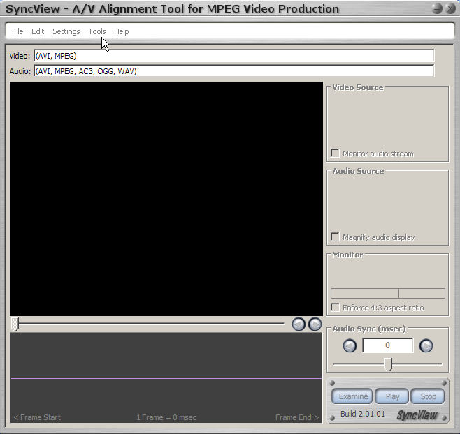

Yeah, it's not exactly intuitive, it's under Tools in the menu.

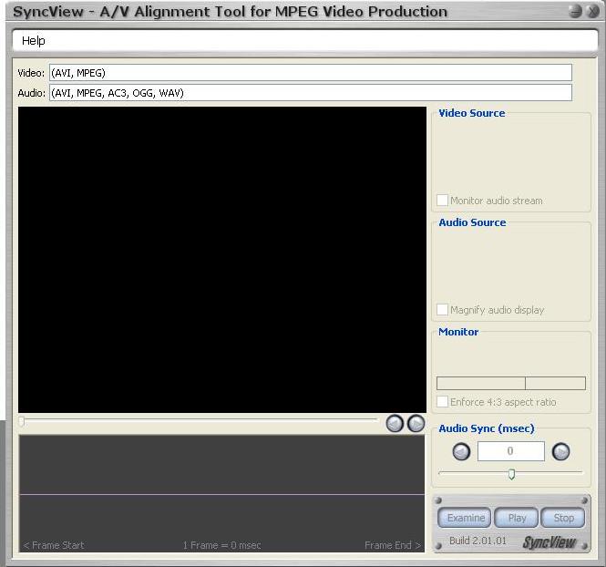

That's very strange! Here's a screen shot of what I see for Version 2.1.1.

I just found this on their forum site, it may explain the problem.
Don't use LARGE fonts or high DPI setting in Windows... (Read 4132 times)
Stefano WWW
113 topics/replies
Your host and developer
Administrator
July 30, 2006, 11:49:11 AM
* Don't use LARGE fonts or high DPI setting in Windows...
I deleted the original message for this topic while removing spam posts
Anyway... the gist of the issue is this:
If you find that SyncView looks strange and that you cannot access certain GUI components, please check your system display settings. SyncView requires the normal DPI setting (96) because it is skinned--and the skin images are intended for 96 DPI.
I will employ a solution to this problem in the next release."Just another sheep boy, duck call, swan
song, idiot son of donkey kong - Julian Cope" -
I was using large fonts. I switched to normal size fonts and now I can see the other options.
Thanks for your help.
