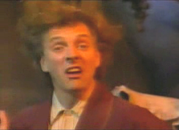

    I have some video files. And the picture contents are a little blurred.
    Can anyone please recommend a good software that will enhance picture quality.

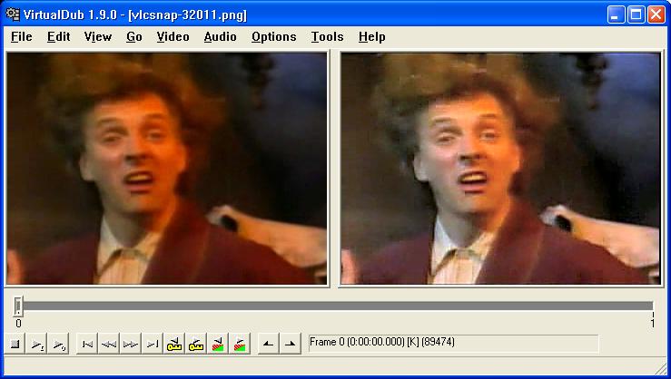

    This is with ColorMill in VirtualDub. I probably messed up the color balance a bit, but it looks a little better. Changing the color had more effect than a bit of sharpening:
    ColorMill for VD: colormill2.1.1.zip

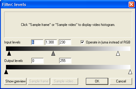

    Or, try this in Virtual Dub:
    Levels: input 0 1.131 255, output 35 255
    Sharpen: 20

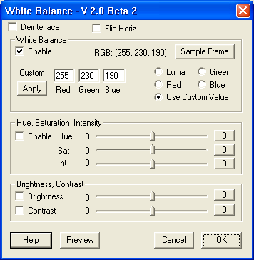

  9. You can also try Unsharpen Mask and a White Balance or Gradiation filter. But you are likely enhance compression artifacts as much as the real edges. It's hard to say exactly what settings to use from one frame which look like it may have abnormal lighting but...
    The gamma correction (levels filter) is probably too much if this is going to TV. Ok for computer viewing.
    Instead of Unsharpen Mask try two Sharpen filters in a row. Both at about 16.

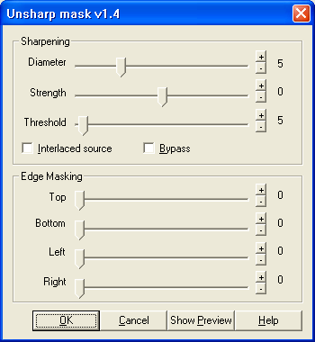

  16. Even after MSU Smart Deblocking there are too many artifacts. The artifacts become much more visible before you get significant sharpening of the underlying image. But try this in VirtualDub: MSU Smart Deblocking followed by Unsharpen Mask at Diameter 7, Strength -1, Threshold ~4. That's still overdoing it but will give you an idea what you can do.
