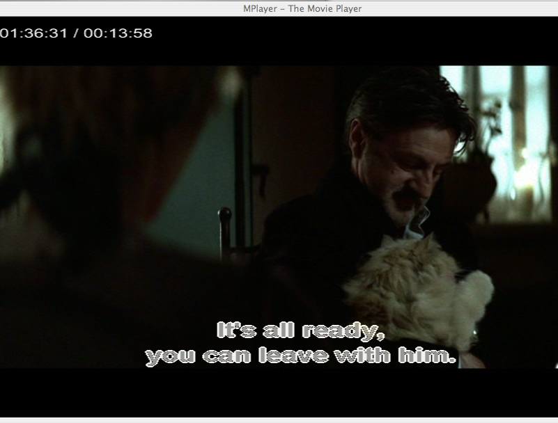

    To add to my last post
    this happens when you select VOB subtitles AND the burn option
    Have a look at the attached preview
    Philippe, Paris

    The "cottage cheese" issue seems to be related to the IFO color palette. The color palette for subtitle streams in VOB files is defined in VTS_01_0.IFO in the DVD's VIDEO_TS folder (for VTS 01).
    For this very purpose, ffmpegX's Filters tab has a field to load the IFO palette by selecting the matching .IFO file.
    DVD subtitles have just four color values, but these four can be mapped to "any" color by use the the color palette. If the original color palette is not used, then ffmpegX will use a default palette. That may be totally different than the original author of the DVD intended. In result, you will see weird things happen to the subtitles.
