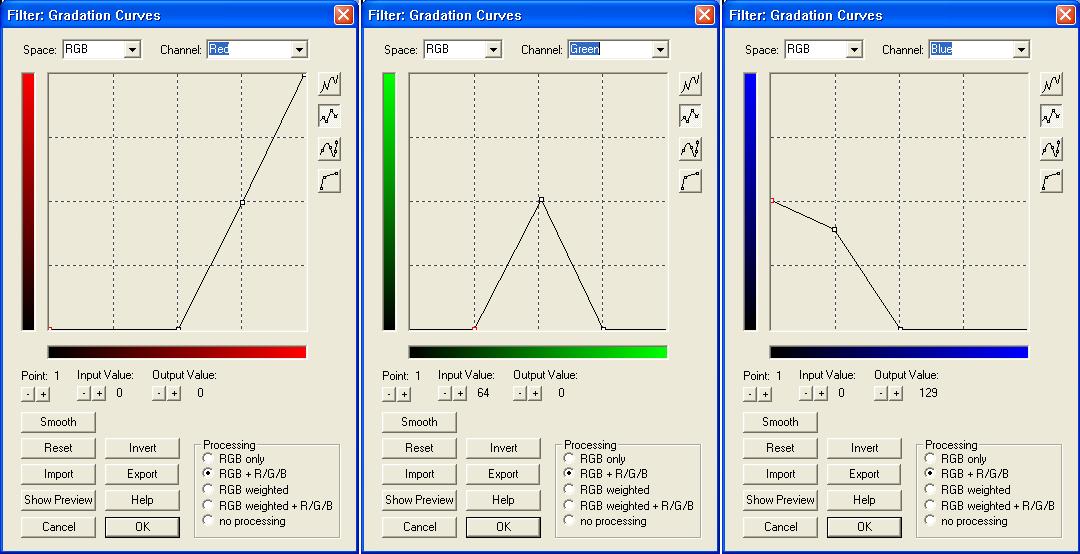

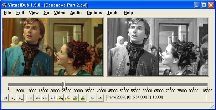

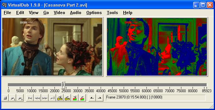

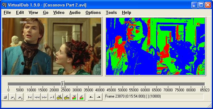

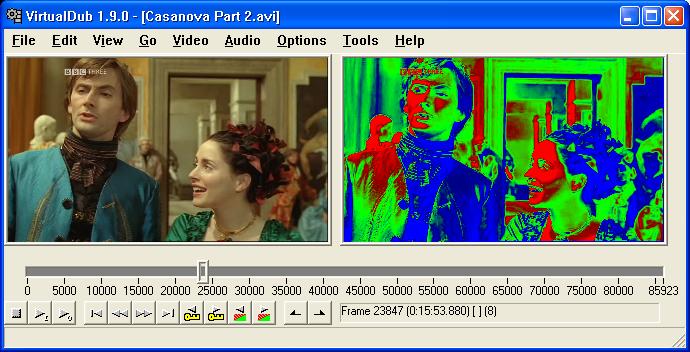

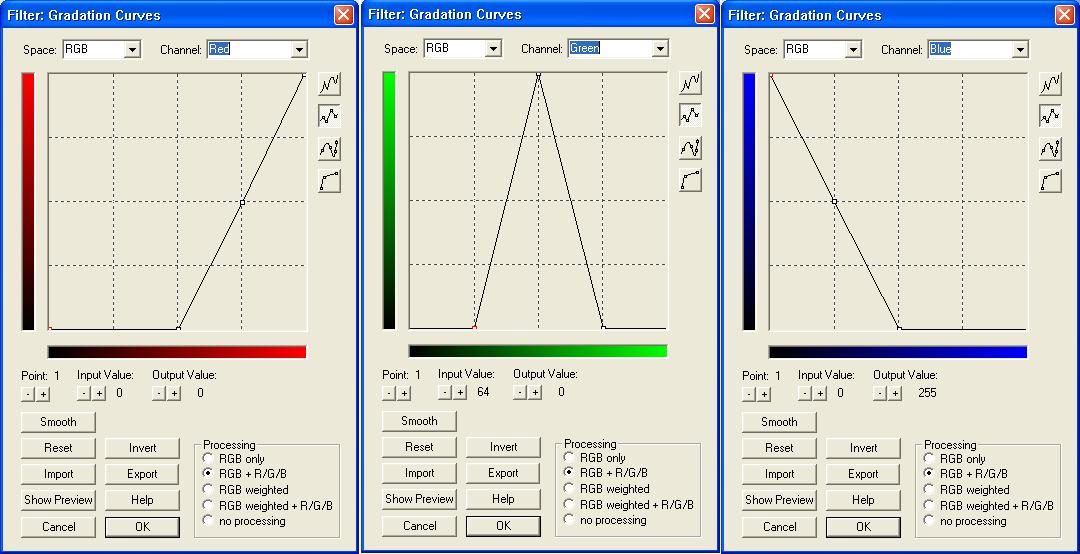

VirtualDub and Gradation Curves.
I first used HSV to reduce to grayscale and Levels to brighten the image a bit:
then Gradation Curves to convert luma to colors, retaining some luma:
with less luma:
with no luma left:
