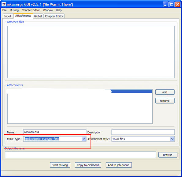

  7. You need to use mkvmergegui, and attach separately, setting the attachment for true type font:
    Using a muxer that supports attachments (i.e. mkvmerge GUI), you simply add your subtitle files to the Matroska file as separate tracks (just like you add audio and video tracks), and any fonts as attachments (make sure they have the MIME type application/x-truetype-font). The fonts will then be installed temporarily by Haali Media Splitter (on Windows) or MPlayer (on *nix and MacOS X) during playback.
    http://aegisub.cellosoft.com/docs/Attaching_subtitles_to_video
    Feb 2009
    Indonesia
    hmmm....i didnt read that part...okay...i'll try it...
    btw, thanks for the fast reply, poison..
    you help me a lot...
    PS: it works!!!!!
    i did a couple of times when deleting the fonts in the font folder in control panel, but the fonts i desire still there in the subs....cool....!!!!
    thankz for the kind explanation there, Poison..

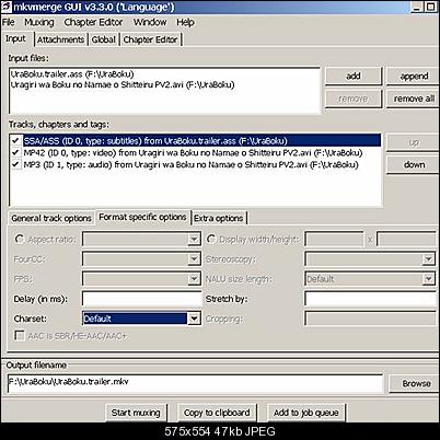

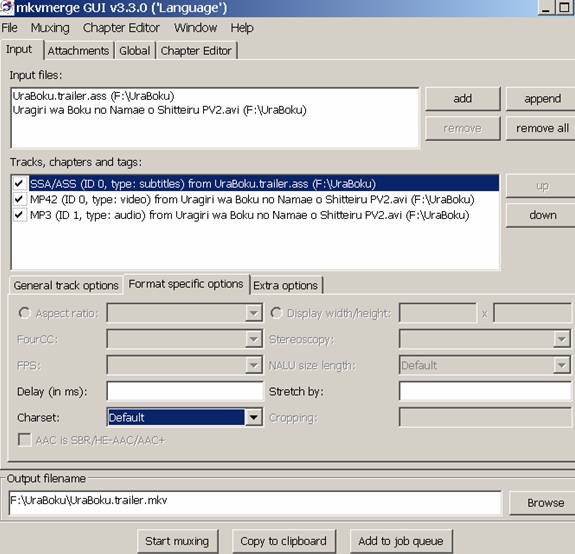

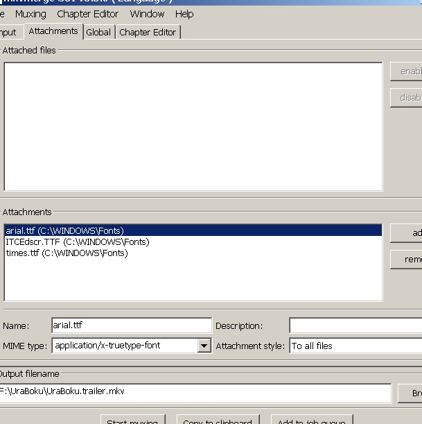

  9. I've got the same problem.
    I'm using Aegisub for the subtitels (.ass) and mkvmerge GUI to mux.
    When I mux the video, the subtitels are there, but wrong (different font, size, color, position). I tried to attach the fonts to mkvmerge but that doesn't work either. The fonts are nothing special (arial, edwardian script and times) and also in truetype.
    Help?
  10. Cut a small sample with MKVMergeGUI of the muxed file for us to look at.
  11. Like this? Otherwise I don't know what/how, sorry <.<

  12. Go to the Global tab, check the "Enable splitting..." box, enter timecodes to cut the file at. Cut a ~30-second segment and upload it to Mediafire, then post the link here.
    edit: actually, just upload the ASS file to Pastebin or Mediafire and link it to us.
  13. Seems okay, not sure what's wrong. Maybe try using the Styles approach to assign fonts to lines (instead of the \fn command).
  14. *sigh* I tried, but that's not working either. Looks like I have to go back to good ol' Movie Maker.
