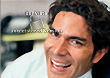

  13. I suspect S-Spline XL will make video look very cartoonish.

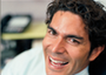

  14. I don't understand, are you upscaling for your project? Do you mean S-Spline XL for photos as in photozoom? How does it compare to normal Spline36Resize() ?
    While TempGaussMC works well for pure interlaced content, I am unsure how well it will do with your blended frames, because it isn't a true bobber in the sense that the original fields are not preserved - it filters them. Maybe you should test it out with the Srestore() function on a small clip before wasting hours/days on the final project?
  15. Originally Posted by poisondeathray
    90x64 source:
    4x enlarged with Spline36Resize() in (AviSynth):
    4x enlarged with S-Spline XL - photo soft mode (Photozoom)
    4x enlarged with S-Spline XL - photo detailed mode (Photozoom)
    Original higher resolution image (90x64 image was made from this with VirtualDub Lanczos3):

  17. I'm not a big fan of the splineXL for video, as jagabo said "cartoonish", the edges are destroyed look especially around his left chin, and hairline. I usually don't upscale video, but I find nnedi interpolation + some form of sharpening e.g. LSF + some form of antialiasing usually gives decent results
