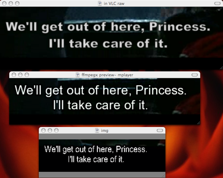

    I've been playing around with ffmpegx and subtitles.... If I am playing an avi movie in VLC or movie player and I download an srt subtitle file, I love how the subtitles appear at the bottom of the screen: the font is very smooth. It looks like plain white arial text on a sort of misty, smooth black cloud, which interferes with neither the text nor the movie.
    In the screenshot image below, you can see how the appearance of the three text formats line up.
    The first image, the one on top, is how a particular selection of text looks in VLC running an srt file for the subtitles. The second image, the one in the middle, is how the text looks in ffmpegx's preview of the movie, and the preview is run using mplayes.
    The third and bottom image is the problem. See how the letters are ragged and the black background of the letters is no longer smooth? (Yes, the text is smaller, but that is not the problem, it looks just as bad, just as ragged in a larger size.) This is how the text looks after ffmpegx creates a disc image of the movie, with the subtitle imbedded in the img file.
    SO you can see the difference, right? I have been playing around with this since Christmas and I can't figure it out. How do I get the appearance of the text to remain the same in the final img file with ffmpegx??

    I think I can explain it, but it won't do you much good: there isn't much you can do to improve it.
    The issue is that your subtitle text is converted from a smooth font rendering *at monitor resolution* to a bitmap image at *movie resolution*. This becomes quite visible because most movie playback is not at 100%, but at full screen (200% or more), when the jaggies in high-contrast-areas (such as non-moving white letter-shapes) show more.
    It is perhaps a bit easier on the eyes with a large font or a bold font, as the raggedness is then a relative smaller percentage of the overall letter shape.
  3. The last subtitle image was resized with a nearest neighbor (aka point) resizing filter. See if there is an option anywhere in your process that lets you select a different resizing filter. Look for bilinear, bicubic, etc.

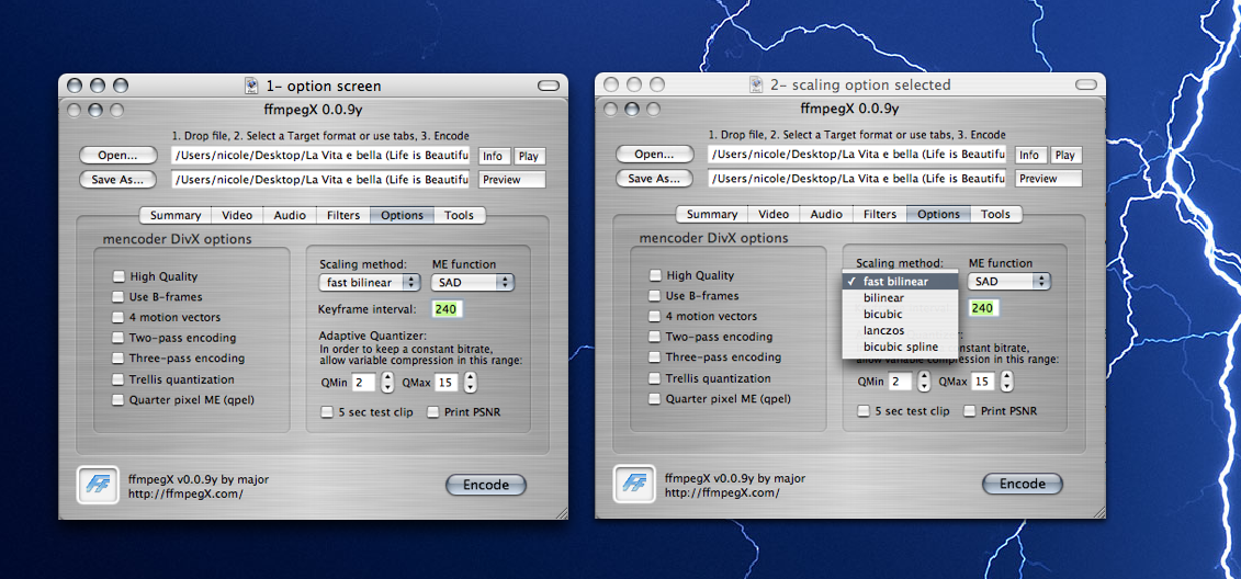

    As for the resizing filter, I did find some of the keywords that you mentioned, jagabo, but not where I was expecting them so I'm not sure what they'll do. Here is a screenshot of where they appear in my version of ffmpegx, is that what you meant? And if so, does it matter which one to select or shall I just go ahead and experiment? (This could take a few days.... 8) )
    Thanks again!
  5. Those resizing options are in the Divx encoder options. I don't know ffmpegx and I don't know exactly what you're doing but I don't think you would be using the Divx encoder when making a DVD. I'm guessing you are making a regular movie DVD since you speak of a "disc image". If you are making a data DVD with Divx files on it you would be using the Divx settings. In any case, it should be easy to run a test using different settings. It looks like the default is Fast Bilinear. Try Bicubic or Lanczos instead.

    jagabo is right about the DivX mencoder options. Mencoder allows for five scaling methods as in the image (each one better and slower than the previous one). But mencoder doesn't encode to MPEG-2 for DVD. And the MPEG-2 encoders in ffmpegX have less settings for scaling.
    Originally Posted by wildgeese
    I am now pretty much thoroughly and utterly confused.
    The available settings in the Options tab depend on the chosen preset. When encoding for DivX, the options will be different from the options for encoding to DVD.
