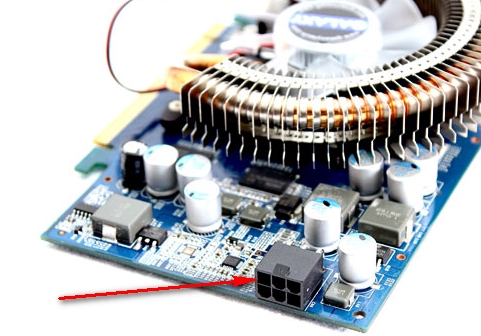

Make sure your power supply has a power connector for the 9500 GT
jagabo: i thought about that "if only it took in consideration the 3 processors i'm sure it would balance the load of the video decoding", but I didn't know the multithreaded h.264 decoder existed... great i'll try that.
Soopafresh: i worried abot that since my motherboard doesn't have extra power cords... only 220v power supply. but after a little search the one I thought of the "Low Rider/Profile" 9500 GT from XFX doesn't need power... or thats what one of the reviewers on the right of the page claims. couldn't find it exactly on the XFX site... but i think hes right:
http://www.newegg.com/Product/Product.aspx?Item=N82E16814150322 -
