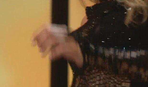

Ok....here's a sample clip. The source is CBS HD in United States, of the Victoria's Secret Fashion Show 2008.
http://www.mediafire.com/file/llzxtmmkmyk/VSFS2008-Sample.m2v
I don't care how long a deinterlacer or bobber takes (honestly I don't know the difference between those 2 either.) I just care about quality.

I agree. I saw no interlace artifacts in the sample. My guess is it was originally 720p, upscaled to 1080p, every other frame discarded, and encoded interlaced.Originally Posted by poisondeathray
In the "old days", 2006 or so such an event would have been shot 1080i/29.97 but the new production trucks can be switched into several formatsOriginally Posted by alcOre

Why would you want to bob it or deinterlace it at all? It's progressive 29.97fps. Each pair of fields is identical - each taken from the same point in time. In your bobbed version, each unique field is followed by a duplicate. -

It's 1080i. But from a 1080p source. For reencoding purposes it can be treated as if it's progressive, meaning no deinterlacing and no bobbing.Originally Posted by edDV
I don't know what they aired but the file contains 29.97 fps 1920x1080 progressive frames encoded as interlaced MPEG2.
My source of this file...I just noticed the intro part of the show, when Heidi Klum is talking/introducing. It was shot at 24fps and telecined to match the fps of the rest of the video. I've encoded the whole thing as progressive, and the intro part is jumpy/ghosting because of the telecine. There's nothing I can do about that right?
The sample is 30 fps progressive frames. Not 24 fps with duplicate frames or pulldown to make 30 fps. If you discard frames to make it 24 fps it you will be missing frames.

Unfortunately, there are "blends" in that footage, where the women is strutting down the runway.
1. At first, I thought, maybe its a 1280x720p 59.94 -> 1920x1080p (flagged or encoded as 'i') because the detail of the images are not clear, and mostly full of pixelation, everywhere. So, that makes it hard to determine pricely the origin and type of source.
2. With the realization of the blends (as found in runway walk) I thought that it could be a part of a snip from sources that were pieces of Time Compression materials, weaved together into this program content. So, you have a mixture of 24p, 60p, 30i, and well, who what else.
3. Then, I thought, again, because there were blends found (during the runway walk) that it might be possible that the actual origin of this vid is PAL, and then pal->ntsc. And we know how variable these pal->ntsc conversion can go: pretty underminable at times.
Then, you have the complications of mixtures of footage, again, 24p, 60p, 30i, (possibly PAL) etc., and everything is just weaved together into a now, 30p though made to look 30i broadcast. Its possible that encoding it to 30i was thought to produce the best results on most displays, and I think they were right on this..course thats just my theory

I'm seeing the multi-frame blending as well. This clip has been processed in some way, probably motion rate altered.

While I was eating dinner, I thought had just occured to me. And then reading edDV's response, I came to the conclusion: special effects.
So, in taking it one more step.. this is actually a special effects mixture added into *some* of those walks, and the errors as was seemingly pereceived (at first glance) is not actually an error, after all LoL, haha.
Access Hollywood, ET, E, etc., all these shows and more.., they all do these funky special effects with fields/frames (aka, blends) and things during panning and zooming, etc. These sources would be encoded as 30p progressive or 30i interlace, if and/or whenever possible. If the source was truely worth it, one could also break it down to the scene level and work out the 30p vs. 30i vs. 24p, etc. and weave them (all) together as one (re)-telecined (aka, interlace) source for encoding. I don't know. I haven't done anything that complicated though mostly because I hadn't anything like this come up in my video endeavors. But I'm sure its quite do-able.
