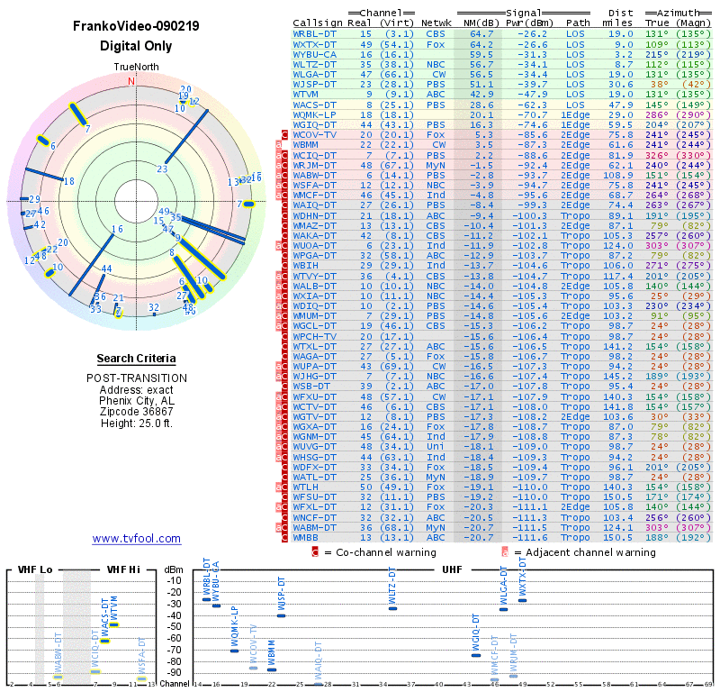

Using Walmart's address in your town, TVFool.com returned this plot. Run your address for more detail.
I'm using the Post Transition plot.
Walmart is in a valley with line of site to only one transmitter WLTZ NBC. The others are in various directions and behind the hills. The CM-3010 antenna is directional with a small gain. It is on the weak side and would need constant retargeting and rescan for your tuner. Yours is a tough case. Post your exact address plot and we can try to optimize. I hope you are higher than this Walmart.

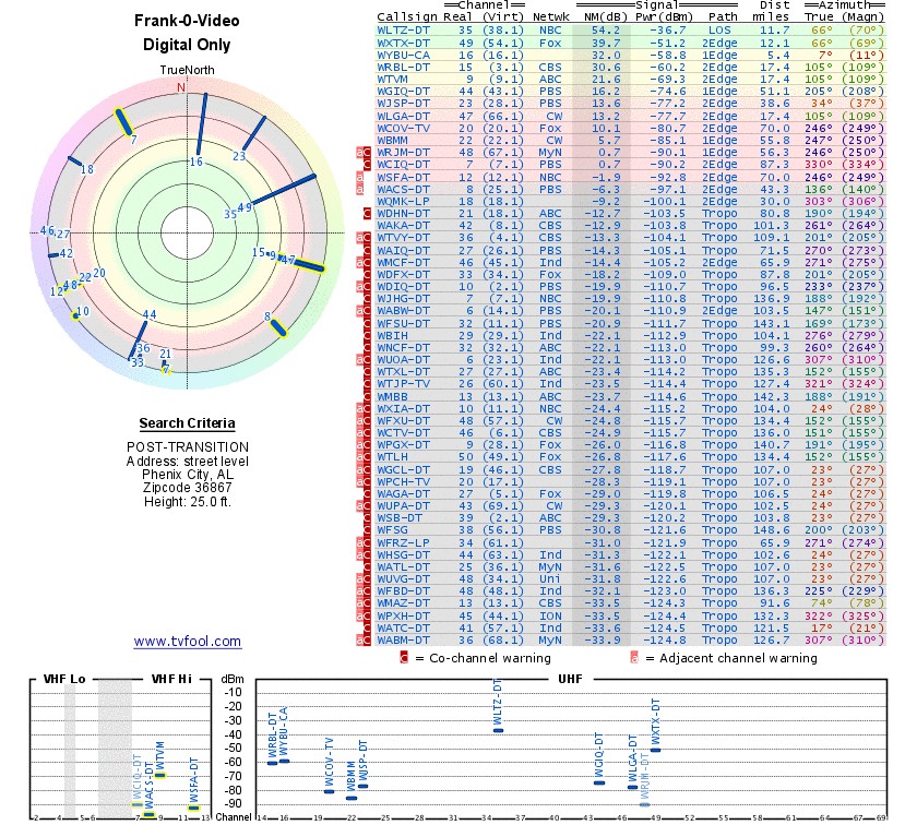

Greetings ...
Just did my own survey, and have attached the image to this post
Thanx-A-Lot, Frank-0-Video
Well that looks much stronger. If you point the new antenna about 120 degrees you should get those line of sight (LOS) stations 19 miles or closer. 16 and 23 would probably need the antenna pointed their way.
You may need a roof antenna and rotor to get others. Don't expect to get much from the 2Edge or Tropo stations.Recommends: Kiva.org - Loans that change lives.
