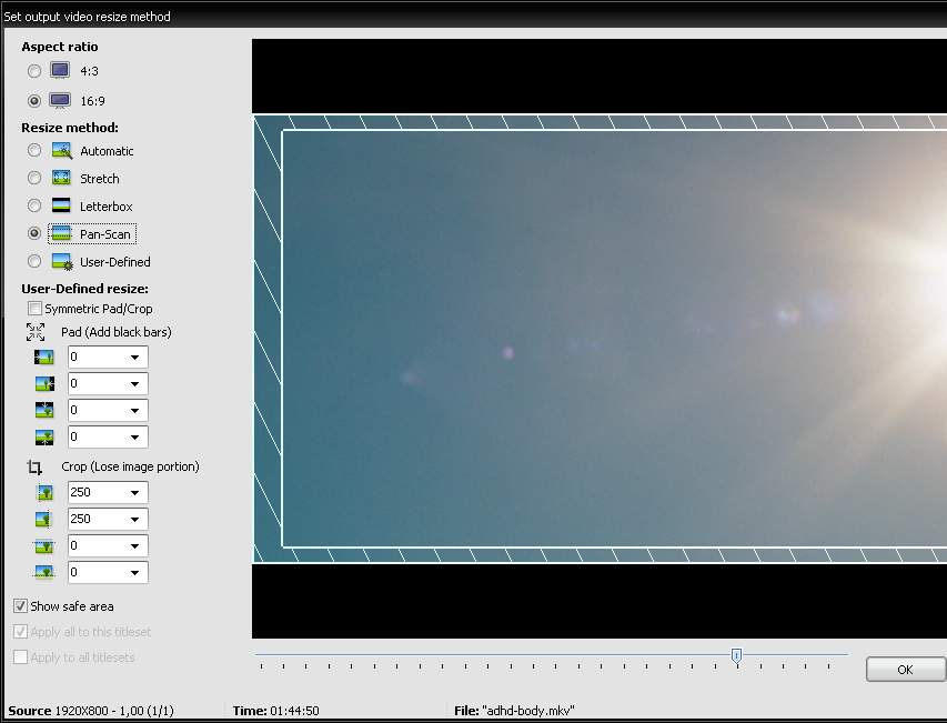

    I guess it would be easiest using ConvertXtoDVD, add the video and click video resize method. See images below
    If you want free tools then would I use avisynth to crop(make the script using fitcd) and convert with hcenc.
    Thanks Baldrick, i will see if there is a trial available and give it a try, it looks like thatīs the thing i need. Iīm totally baffled that a professional software like Tmpgenc Xpress does NOT offer such an option (or did i overlook it?).

    I haven't tried tmpenc xpress but I'm pretty sure it should be able to crop the video, check the help for cropping/crop.
  6. TMPGEnc Plus has the option to crop to 16:9. Under Video Arrange Method select No Margin (Keep Aspect Ratio). And elect to make a 16:9 MPG file.
    I bet Tmpgenc Xpress has the option too.
