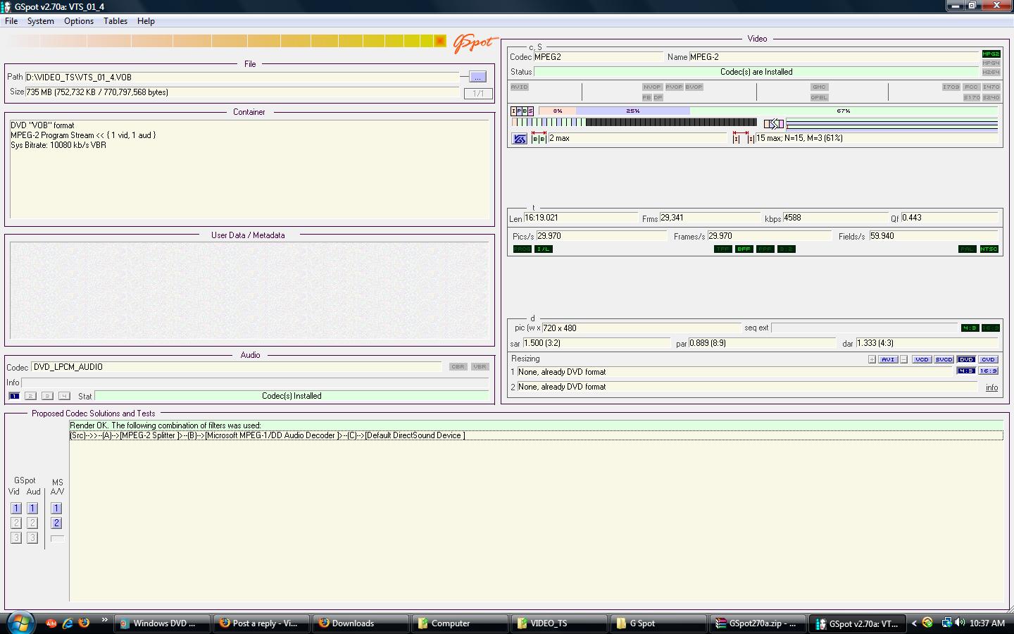

Opening .VOB files in GSpot shows there is sound. . .

You have an audio (LPCM) usualy for NTSC it is AC3 type which is mandatory, but look at your bitrate (10080), that is maximum allowed for video and audio included. Not too many stand alone players will be fine with such a high bitrate.
Try to encode audio to AC3 and video to around 6000 VBR, it may help.
What you are showing is VTS_01_4, what are others? (_0,_1,_2, _3) -

Why is the audio LPCM? It takes up 10 x more space than the highest quality AC3. You have to be an extreme audiophile to choose this format.
OK. All three are the same format, but what I overlooked is that 10080 is encoded as VBR, which will definetly place bitrate peaks out of the spects. If you ever go that high, it should be encoded in CBR, than you are sure that it is the highest bitrate. But what I saied before, about that high bitrate, still stand.
