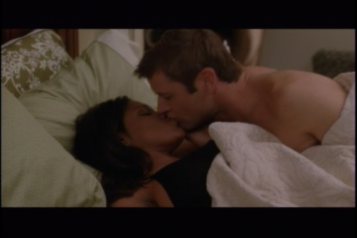

I have a Wonder 650 USB tv tuner card. I installed the software that came with the tv tuner card. Next, I recorded the HD channel on my DVR and played/recorded a privated practice from my DVR to my computer so I could capture the episode using the KMPlayer. The caps came out blurred and out of focus. What am I doing wrong? I am very new to this and feeling my way through.. I did this on my laptop, which is XP.
I also configured the windows media center and the TV tuner card without the software from ATI/Visiontek and it produced the same results
Finally ... is there a way to streem live tv using the tv tuner card and the KMPlayer
a picture of my cap

Still very confused.I am thankful for any help -
The feed to the dvr is a HD channel? ie. from the cablebox / sat ?
You are recording SD (720x480) so there is a massive loss in resolution
I think those Wonder TV Cards can capture HD, but only free to air sat.
Most DVR's have ports blocked or encryption, so you can't just transfer the data over to the PC losslessly. Check your specific model's forum for possible work arounds -
If that cap you posted is a correct representation, you have a problem somewhere. The info you posted from the file shows regular DVD type resolution and settings. If the source was good enough quality, you should have a DVD quality video file. If the original was much better, something seems to have been lost along the way.
The horizontal resolution looks about right for a digital cable or DVR cap (usually about 512 pixels across). The image appears to have been drop-field deinterlaced resulting in loss of vertical resolution and jagged near-horizontal edges.
I'm trying to understand the process here.
First, you capture from sat box to DVR. Then, playback from DVR to laptop (connected HOW?) and capture with KMPLAYER. Then, you playback that secondary capture source and capture a THIRD TIME, presumably with the ATI card (Connected HOW?), and now you are wondering why a third-generation capture shows loss??? Or are you referring to SCREEN CAPS only for the third instance?
Recommend eliminating MULTIPLE re-encoding loss by simply recording the show direct to ATI card from the Sat box using the S-video input. This will also minimize or eliminate issues caused by having multiple softwares with settings you are not familiar with.
