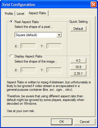

I have a wintv-pvr-350 card and have captured approx 100 episodes of Mad About You off of my Tivo. The initial title image that is displayed by the Tivo is 4:3, but once the show starts it is more like 4:3.75. The only other thing that I have captured came out fine. (Tiger Woods chip shot on #16 at the Masters)
Anyway, I am using VirtualDub-MPEG2 to do the conversion to xvid, and I've tried divx as well. The file information from Virtual Dub says that the Frame Size is 720x480, 29.970fps, Aspect Ratio is DAR=2(4:3).
Is there a way to stretch this back out when I convert from MPEG2->xvid?
Let me know what other information is needed.
Thanks! I tried working with this configuration screen, but I must have been changing too many things at once. Changing just the DAP fixes it.
