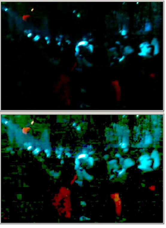

    I had to convert this to mpeg4/divx first using mencoder.
    I used a vdub filter to crank up the RGB (gamma) and when you compare frame to frame, on some frames a bit more detail comes up but the overall image suffers. It was just a test so I didn't save any output but I took a couple of snaps. (Top original)
    So you don't get too excited look at the distortion when you crank it up too high (3)
    There's not much to do but then I can't do much anyway.

  9. AviSynth can pull a little more detail out of the dark areas but it's mostly quantization noise. Here's the same frame as gll99's second pair with a similar (too much) gamma stretch:
    Notice how areas of his image that are pure black still have some detail here. But it's nothing you want to see.
