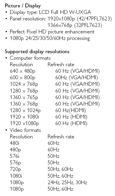

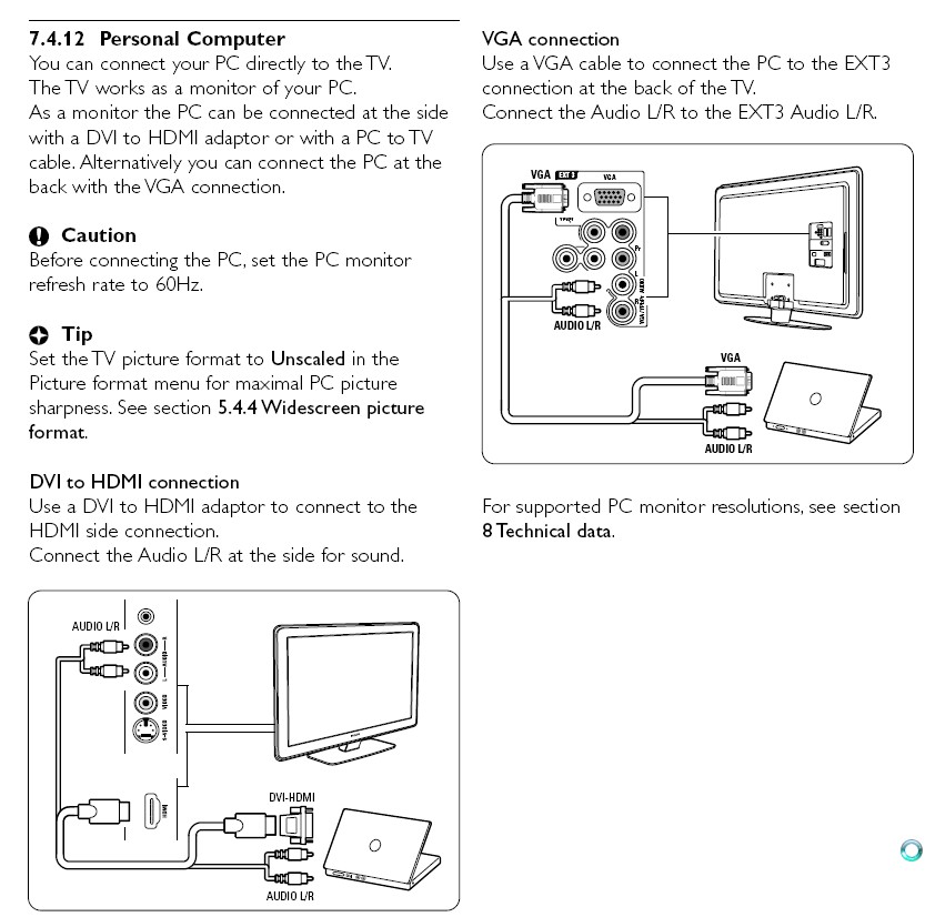

OK, I found the manual for your HDTV.
http://www.p4c.philips.com/files/3/32pfl7623d_10/32pfl7623d_10_dfu_eng.pdf

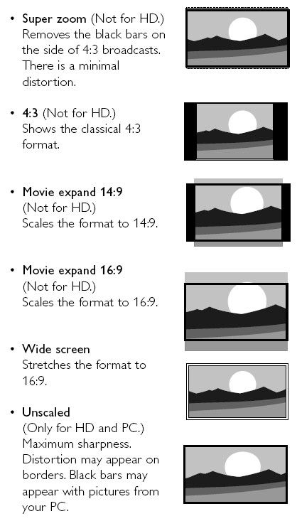

To eliminate scaling in the TV, set as follows. It is important to realize that this turns off all picture processing in the TV other than simple brightness and contrast. You are now at the mercy of your software players and display card hardware for picture processing.
If you were to switch TV inputs from the PC to a direct tuner (1080i/720p/576i) you would need to change from unscaled to one of the other TV display modes so that the TV can scale input to panel resolution 1366x768.
P-38 connecting a Personal Computer...
P-14 "Widescreen picture format" Set to unscaled.
P-41 "Supported display resolutions" Set display card output (VGA or DVI-D to HDMI) to 1360x768.
