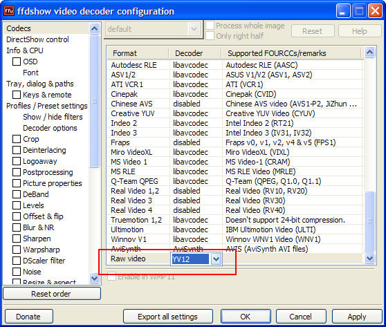

xvid4psp comes up with an error when I open my .VOB file saying:
"You don't have YV12 decoder! It's needed for source interlace detection" where can I download this decoder and once downloaded, where do I place it? -

also, the ffdshow method did not work, the same error message still appears -
I still get the same error message.

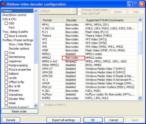

I think it is not properly decrypted, or there is a sequence at the beginning that is causing this. Some copy protections use this method of putting garbage at the beginning. Did you use the most recent version of DVDFab? Do you have anydvd ? Try using that

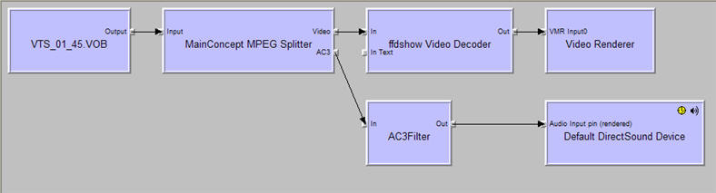

If you load the vob into graphstudio and render it, it will show the filters being used in directshow. Do the pins connect and what splitter are you using?

This is the file opened with graphstudio:
Many codec packs will install ffdshow, but you should install it separatelyOriginally Posted by Seeker47
It might cause conflicts, but this is rare. It is highly configurable, and you can enable/disable different decoders easily with drop down menus
It's probably the most common decoder pack installed because it decodes almost everything when configured properly
It is definitely safe to install this one. There is active development and it is constantly improved/updated. -
Nitro89 - when you push play in graphstudio, is it still grey screen?
Can you try other vob's in MPC / graphstudio ? (ie. is the problem isolated to this particular movie or a system problem with directshow?) -
yes, when I push play in graphstudio I get the grey screen.
