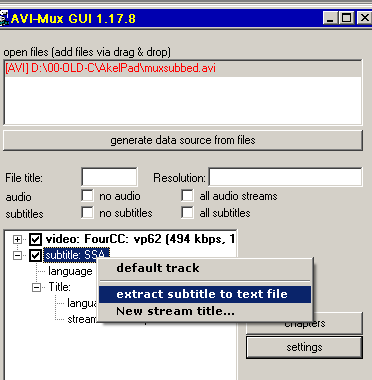

    Try extracting the subtitles with AVI-Mux GUI ---
    --- which can function as an MKV muxer as well.
    Feb 2009
    How do you get AVI-Mux to extract them? It seems to be a Muxer only.
  4. Banned
    Jun 2007
    UNREACHABLE
    Use the right button of the mouse.
