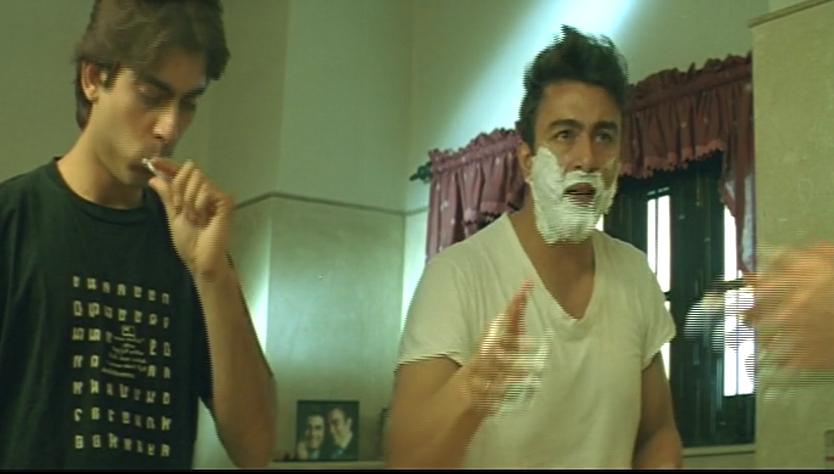

Hello all,
i am new to this conversion procedures.
i am using Xvid4PSP to convert my DVD collection to MKV.
I have uploaded the image which showcases my problem and the lines are seen at much places of the movie
the dvd i am converting is at 29.97 fps and it is showing progressive type.
what are the settings to rectify my problem.

IVTC it if it's film based (a movie), deinterlace it if video based, and if it's the common Indian field-blended garbage, unblend it. If you could post a small unprocessed sample from the source more definitive advice can be offered.
Although it may have been encoded as progressive (where'd you get that information?), it's interlaced. -
