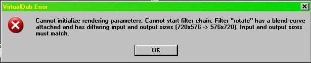

    Hi,
    I am trying out the filter & blend in VD.
    However I got this prompt (see attached).
    Where do I change output size?
    Thank you.
    Edit 16Feb2009:
    I found out that I should have used ROTATE2 and not ROTATE.
    I no longer get the error message.
    Thanks.
