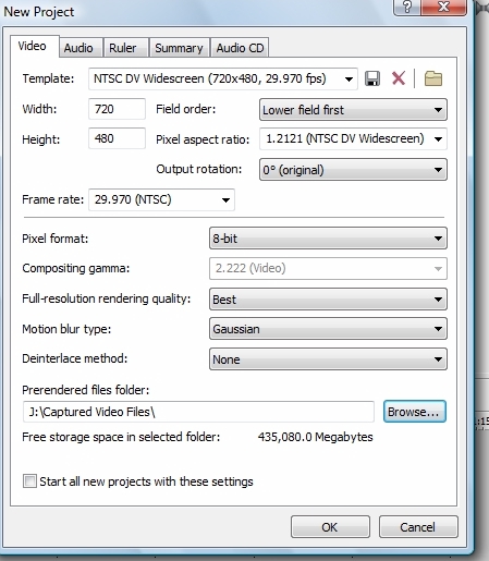

you need to start by adjusting the file properties of the captured DVavi source. vegas most likely doesn't know it's widescreen as it's size is normal 720x480. right click on the source/properties and adjust the pixel aspect ratio to DV widescreen. then the video should show up in the preview window correctly. when rendering select 16x9 display and do not letterbox to keep it 16x9.
Thanks! So should I capture...then alter the properties? Also, should I check the box that says Stretch video and do not letterbox? I was thinking I should not check that box because I don't want to stretch the image. In addition, should I select the 16X9 DVDA template for rendering or the standard?
It's important to follow an organized work flow when editing. Train yourself to set up the project properties as a part of starting a new project. After the project properties are set, then capture your footage. You will save yourself grief later if you follow an organized and consistent process. If you setup the project properties first for 16:9, it won't subsequently ask if you want to stretch it. Just confirm when you render that it is set to render as 16:9. Do NOT select letterbox.
Okay, but should i actually check the box that says "do not letterbox"? If I do that, the box also states that it will stretch my video to fill screen.
Can anyone offer a good screen shot of the correct properties to set up a 16X9 DV Capture? -
Thanks....what a great site. I really appreciate your quick response. Lastly, anything special that I must do when setting up a DVDArchitect widescreen project to burn?
