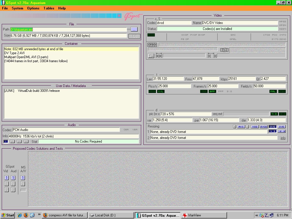

    Pls see attached.

    The videos are already in the best format for editing. Choosing to recompress them to save space will cost you a quality hit not, when you re-encode, and potentially again down the track when you edit.
    Keep it as-is, and keep your tapes and a camera to transfer with.
