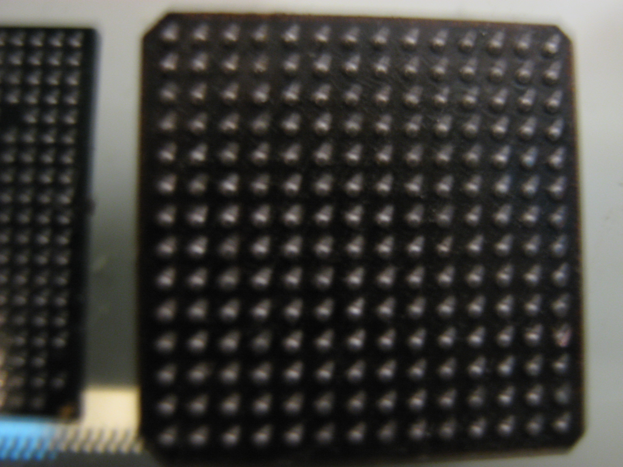

I was very surprised that in China, street stall technicians can swap out the cpu in about 1 minute.
See screenshot (click on below link) for pictures of cell phone cpu's. The cpu typically is less than 1cm square and has about 300 contacts. Street tech uses a heat gun to heat up and loosen the original cpu and use a heat gun again to attach the new cpu. Typical price is about US$15 total to change the cpu.
Question #1: In the US, is this done? Or do they just throw out the phone?
Question #2: I don't understand how the new cpu can be aligned so that the contacts line up. There is no alignment device as with a computer cpu. Also, how can the tech be sure that all the contacts are soldered to the circuit board?

I can't imagine street kiosk resoldering a 300 pin CPU/FPU/ASIC. I'd like to see this.
I agree these don't fail but it would make a good magic show.

Many VSL ICs are now ball grid array packaged. At least two good things come out of this: the entire IC area can be used for the vast pin count (as against only on edges as in PLCC and DIP), and there are no pins but contact points in an array preapplied with blobs of solder on each contact. The contacts on the PCB the IC is to be soldered on are also preapplied with solder, which are heated and they become liquid. When the IC is put on top, surface tension between any two liquid solder blobs are enough to nudge the IC in perfect alignment with the contacts and at the same time get soldered on the right spots perfectly.Question #2: I don't understand how the new cpu can be aligned so that the contacts line up. There is no alignment device as with a computer cpu. Also, how can the tech be sure that all the contacts are soldered to the circuit board?For the nth time, with the possible exception of certain Intel processors, I don't have/ever owned anything whose name starts with "i".
Street techs repair any kind of phone. I believe all phones are Chinese made (Nokia, Anycall, Motorola, etc). I don't think China imports any consumer products. Even those brands of other countries, are all made in China. I have watched the street techs work, and they really can unsolder and solder any part in less than a minute, no matter how many contacts or complex the part is.

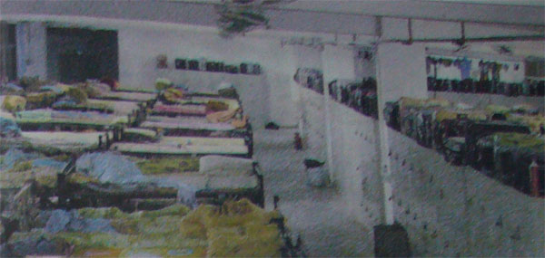

reminded me of the Apple/Foxconn story few years agoOriginally Posted by INFRATOM
http://www.macnn.com/articles/06/08/17/apple.finds.labor.abuses/
PIX
http://www.appleinsider.com/articles/06/06/14/photos_inside_foxconns_ipod_city.html
