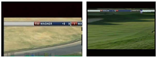

However, when I put them into my computer (Win2000) I have this problem: The DVD can be read and all the files are shown, I can also copy them (either by drag and drop or ripping) on my computer harddrive. But the dvd won't play properly: When opening it in Power DVD I get an error code saying "The DVD disc might have been damaged so as to inhibit playback operation".
I can open the vob files separately, BUT the first one seems to have a problem; the image is pushed to a corner so that only part can be seen and it is pixelated and jittery, or it just flickers black and green. I have this effect with various dvd software (Power DVD, VLC, Windows Media Player just plain crashes with an error message before opening any image at all) and with both my disc drives. I have also tried it at work on different pcs and with other drives and software. The VTS_01_1.VOB just won't play right. The second or later vob files usually play okay (won't work with VLC sometimes).
Screenshots for comparison of non-working compared to working vob file from the same disc see below, captured in Power DVD:

Given the fact that the DVDs are finalised and do play without a problem on standalone players, and that the files can be copied or ripped, I would think that the vob files and the data as such are not totally corrupt? But with 1.VOB displaying the same problems when opened in any of my dvd software, there must be *something* wrong somewhere.

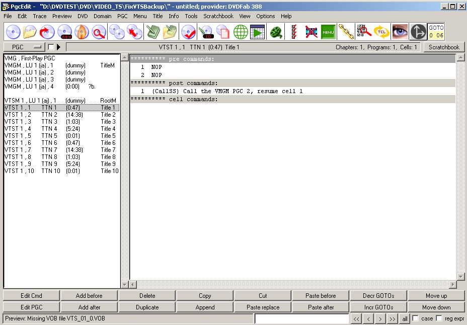

I have now tried:
VOB2MPG - creates a 1.43 gig mpg or so file from the vobs, then tried to author this with GUI for dvdauthor. There it said "no real mpg file" and "no sequence header found" (I installed the German version but this is how I would translate the error messages that came up).
FixVTS - no effect, the created 01_1.VOB still plays faulty
PgcEdit - result says "Missing VOB file VTS_01_0.VOB, when trying to preview the full dvd, and error message comes up saying "Error while loading VOB file ....\VTS_01_1.VOB Could it be encrypted?"
screenshot from PgcEdit:
http://www.absoluterabbit.com/pix/pgc_screen.jpg
Does any of this help to determine what is wrong with that VOB file? This confuses me more by the minute; the thing plays fine on my standalone player so the data must be hidden SOMEWHERE in there, why in the world can't any of the software progs work with it?
